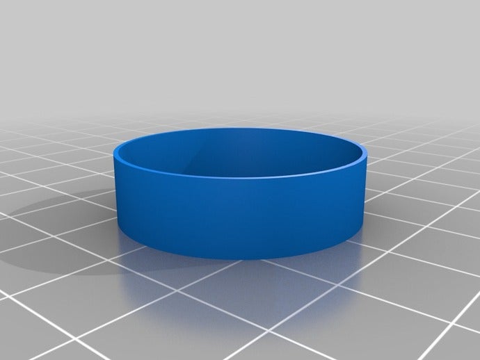

@Cal_Aim Can you print this file at full speed? If there’s Z issues it should show up at the same height on this model.
@Adam_Steinmark Weird ! it looks perfect even though I ran it at 100%…Maybe its the CAD model?
@Cal_Aim Well you do have a delta so it may be the angle of the arm that’s an issue. If you link me the model I can take a look at that though just to rule it out.
Next print test is gonna be a cylinder at roughly similar diameter as the original print. If you don’t want to model one you can use the link below and scale it. Make sure it’s at least 100 mm tall.
