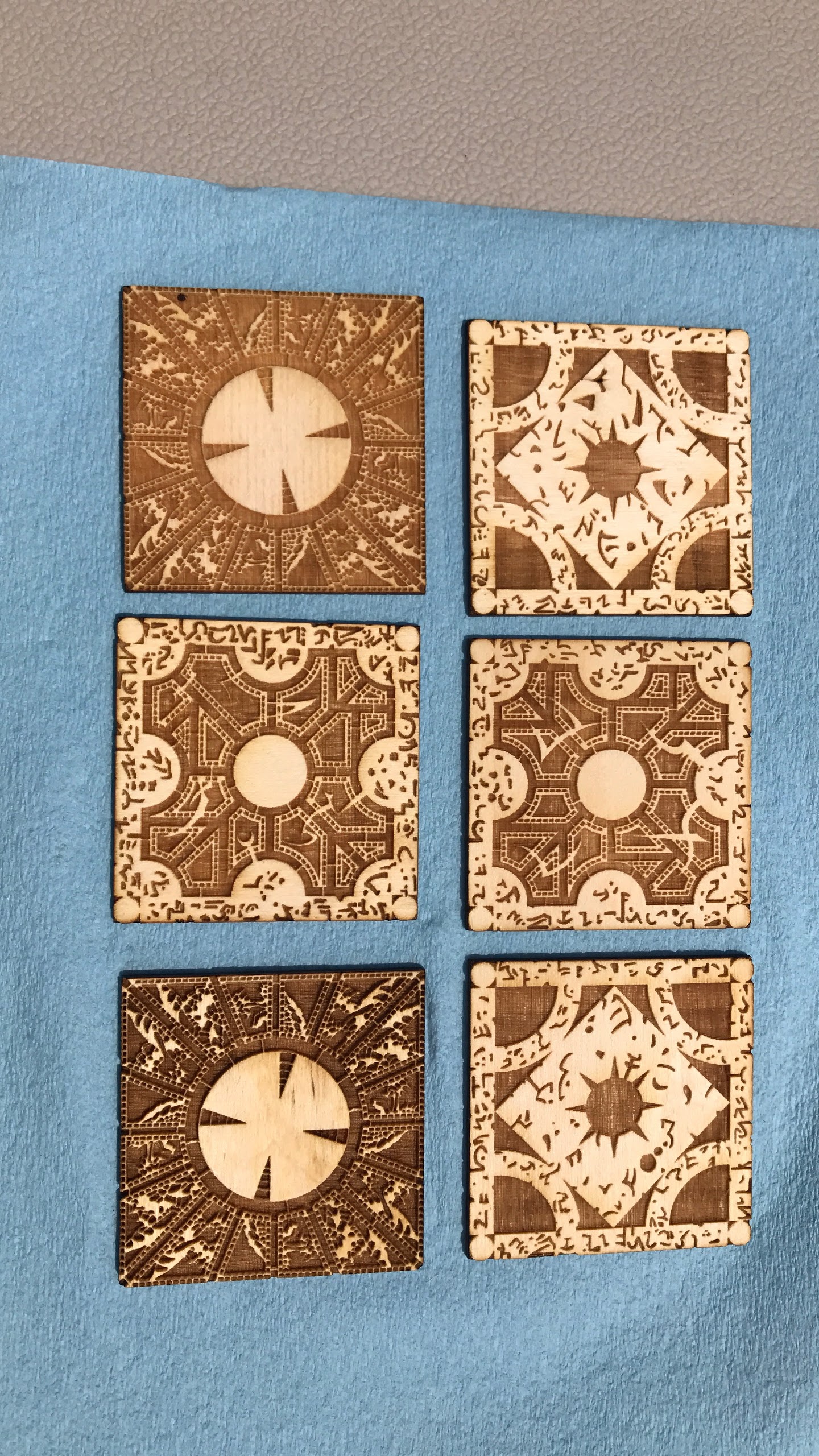

https://imgur.com/a/QS2WE Always wanted to make a Hellraiser Lament box and used the info from
Always wanted to make a Hellraiser Lament box and used the info from https://www.thingiverse.com/thing:1150234
3mm Baltic birch plywood. I sanded the edges to 45degrees using a disk sander and then glued the six sides together.
This is the Laserweb4 json save file (zipped format) if you want to make your own
https://filebin.net/qjp2waq8lwo8zjaj

@Jim_Fong thanks for the file. I ran it and only changed the raster speed to 75 and set $33=3000. Pot was set to 10ma. Bottom left square was run through twice. I haven’t touched them other than a toothbrush under water.
