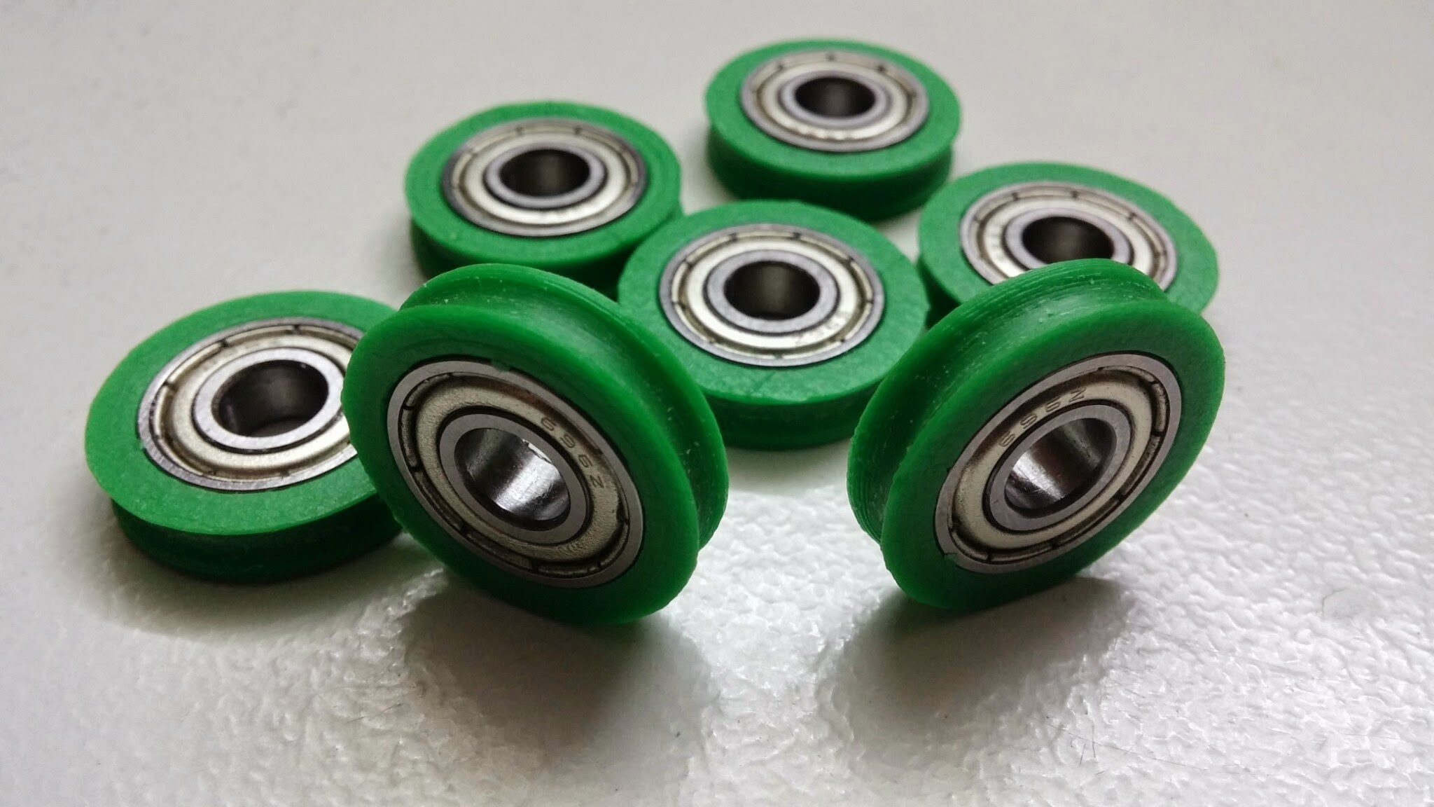

Originally shared by Marc Schönfleisch
Made 3d printed wheels to exchange the packing tape by dyneema cord.
They fit tight on the 696 bearing. To make them realy round i put them into the power drill and while spinning used a round file.

whell done Marc! print and correct with powertool
Nearly the same idea for m5 : https://www.youmagine.com/designs/cord-guide

uploaded the wheels to http://youmagine.com
https://www.youmagine.com/designs/cord-pulley-guide-for-quadrap-3d-printer
i use 4 lines of 0,3mm dyneema fishing line parallel, because this was laying arround here. For me it works better than packing tape although it is about the same flexibility when pushing on the z-stage per hand.
Think best would be 1.3 or 1.5mm dyneema cord like this http://www.ebay.de/itm/Drachenschnur-Dyneema-100m-30-50-70-95-130-180-230-260-500daN-weis-0-3-bis-1-8mm-/350724388470?pt=LH_DefaultDomain_77&var=&hash=item51a8cd7676
But it is very expensive. I havent found a source where one can buy only a few meters needed for the z-stage.
