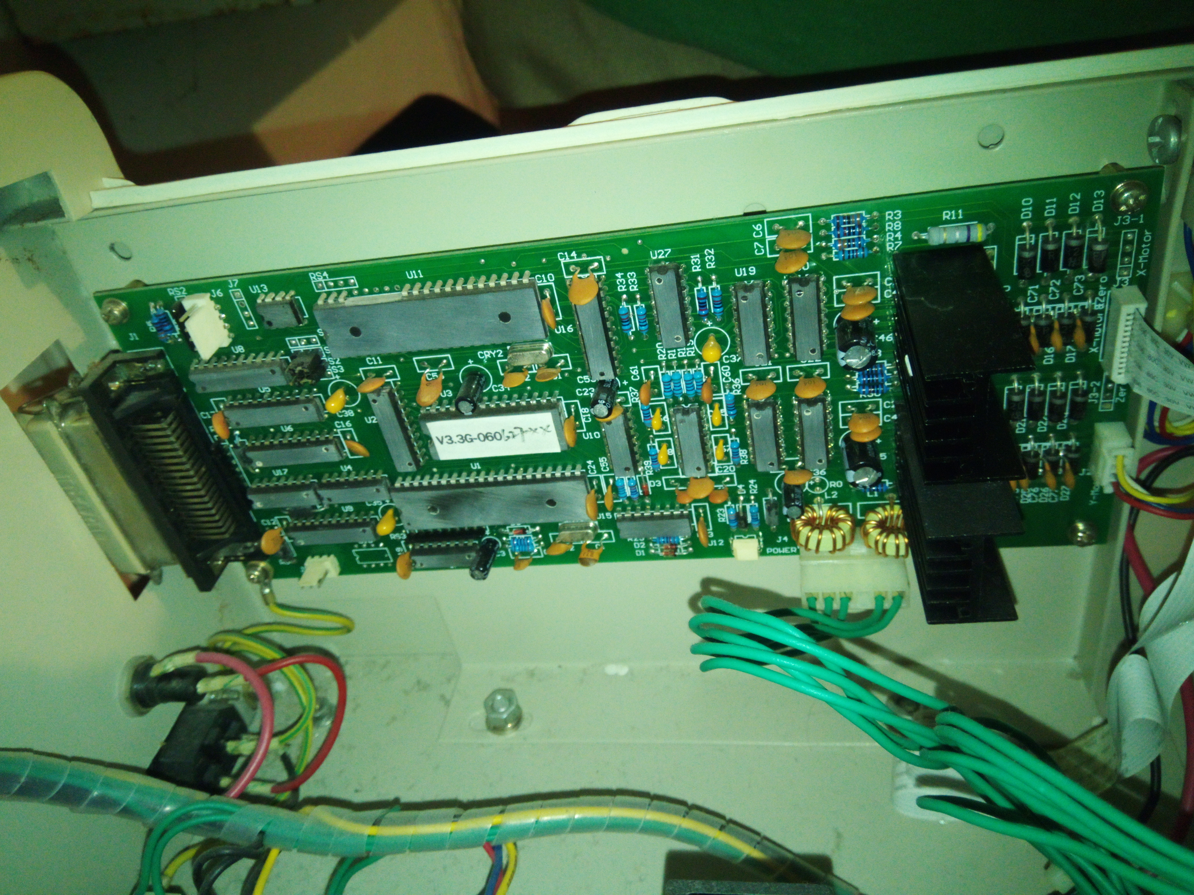

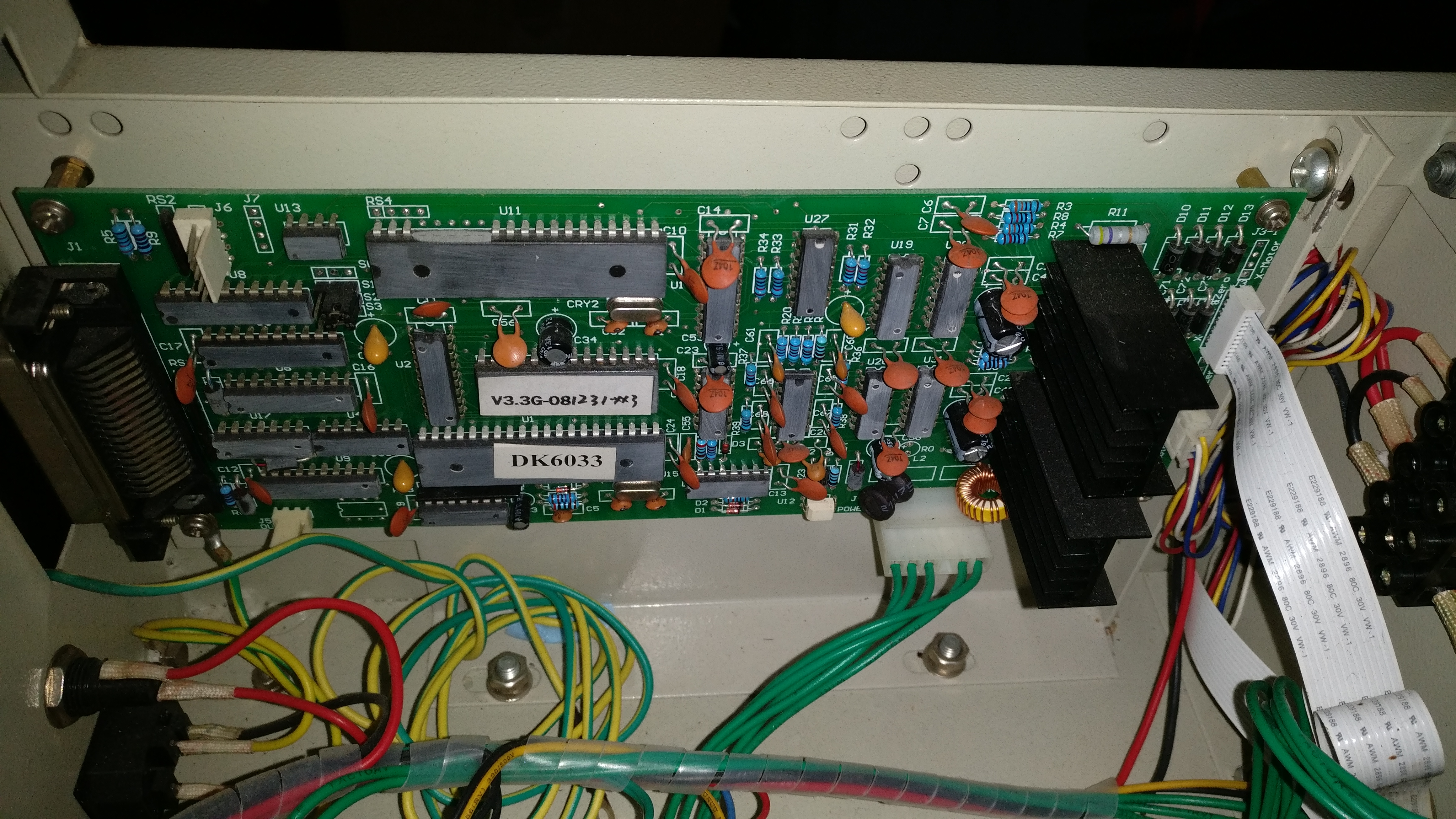

@Drazen_Lukic did you ever take look at the controller board? (the board the USB cable plugs into) Like @Nednam I would be interested in seeing a picture.
The only picture I was able to find was from an old G+ Cohesion3d post where @raykholo was helping someone convert one over to a mini board.
Here is the link for while it lasts
https://plus.google.com/108403577695975026405/posts/52xTDYZB9gj
Ah, that guy.
It has the same ribbon cable as the K40 but that’s about it, don’t know that it would be compatible with Whisperer.
I have been trying to figure out what controller boards use Newlydraw. The board in the picture is parallel port driven so I am guessing it does not support Newlydraw.
Based on the information in the document linked below about Newlydraw I would surmise that the boards Newlydraw supports would be USB based and some of the boards it supports may have PWM power control.
http://www.rabbitlaserusa.com/DriverDisk/NewlyDraw/Newlydraw1%20manual.pdf
I don’t know. Newlydraw may support both USB and parallel port boards.
Just to be clear, the boards that have been pictured in this thread so far are definitively not supported by K40 Whisperer.

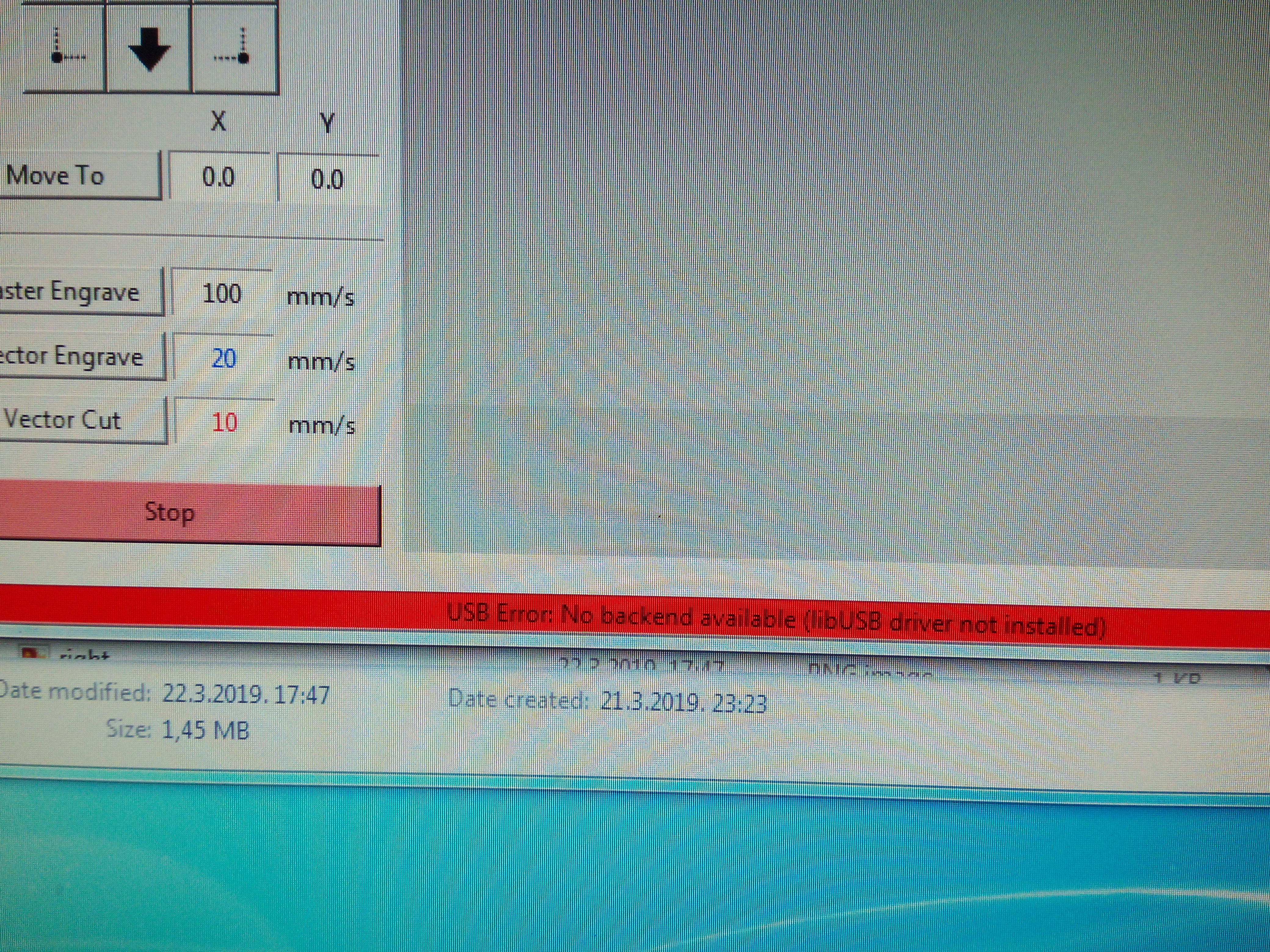

This message I get
You could install the drivers that K40 Whisperer uses to get rid of that error but K40 Whisperer will not work with your controller board. K40 Whisperer has no ability to talk to a laser controller through a parallel port and it does not look like the company Lihuiyu made that board.

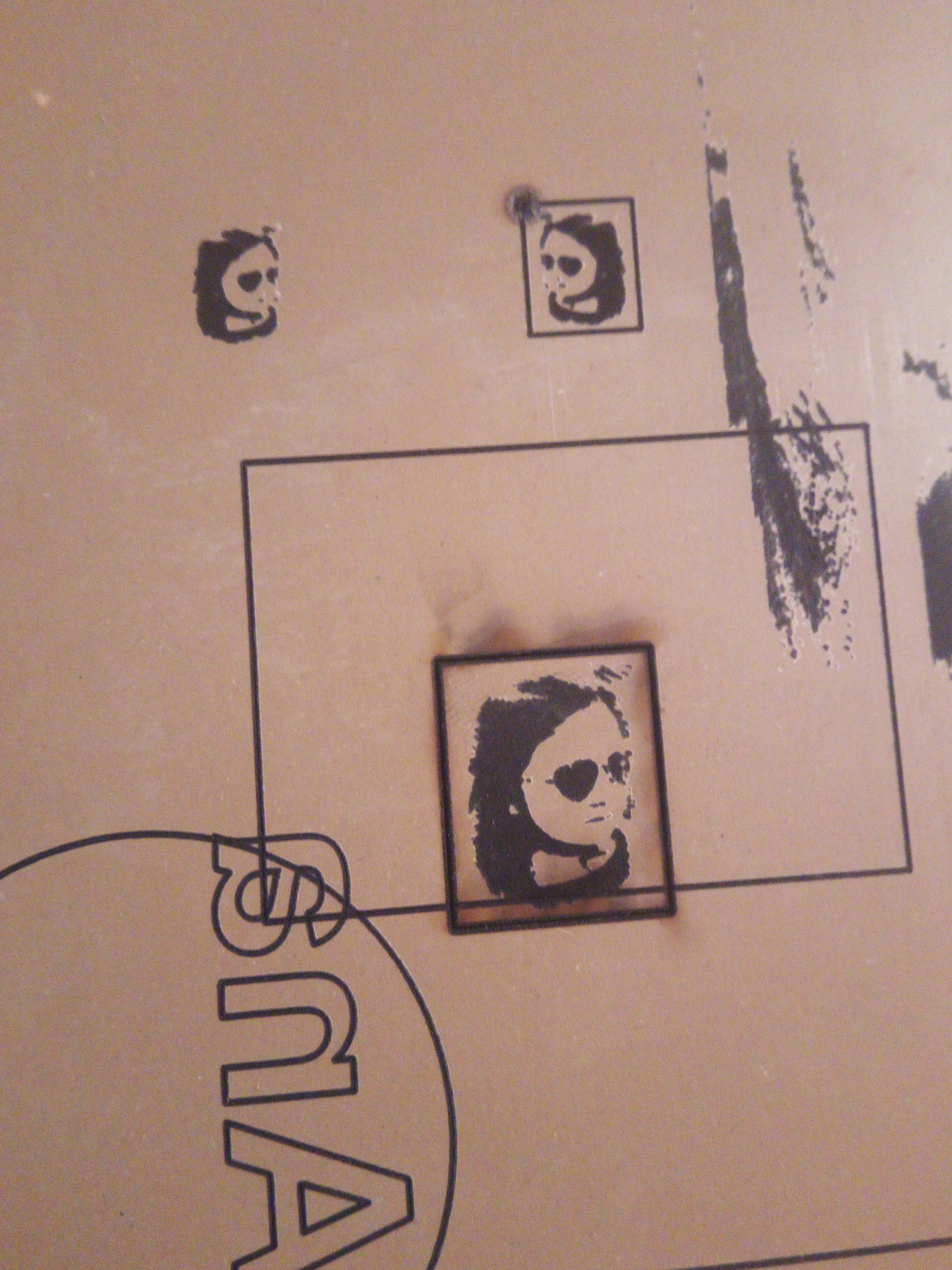

Now its look good with Newlydraw 1.5
