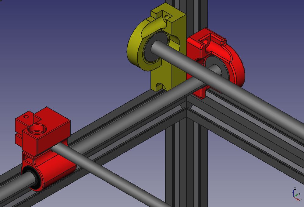

I aborted my built and went with the dual wire gantry, right now stuck on the drawing board somewhere.
This is how I plan the rods positioning back then. One axis use different bearing holders and use the frame extrusion as reference. I imagine need to loose up one axis and burn in to achieve smooth motion before tightening up again.
A simple stl is in here for the adventurous one to try:
