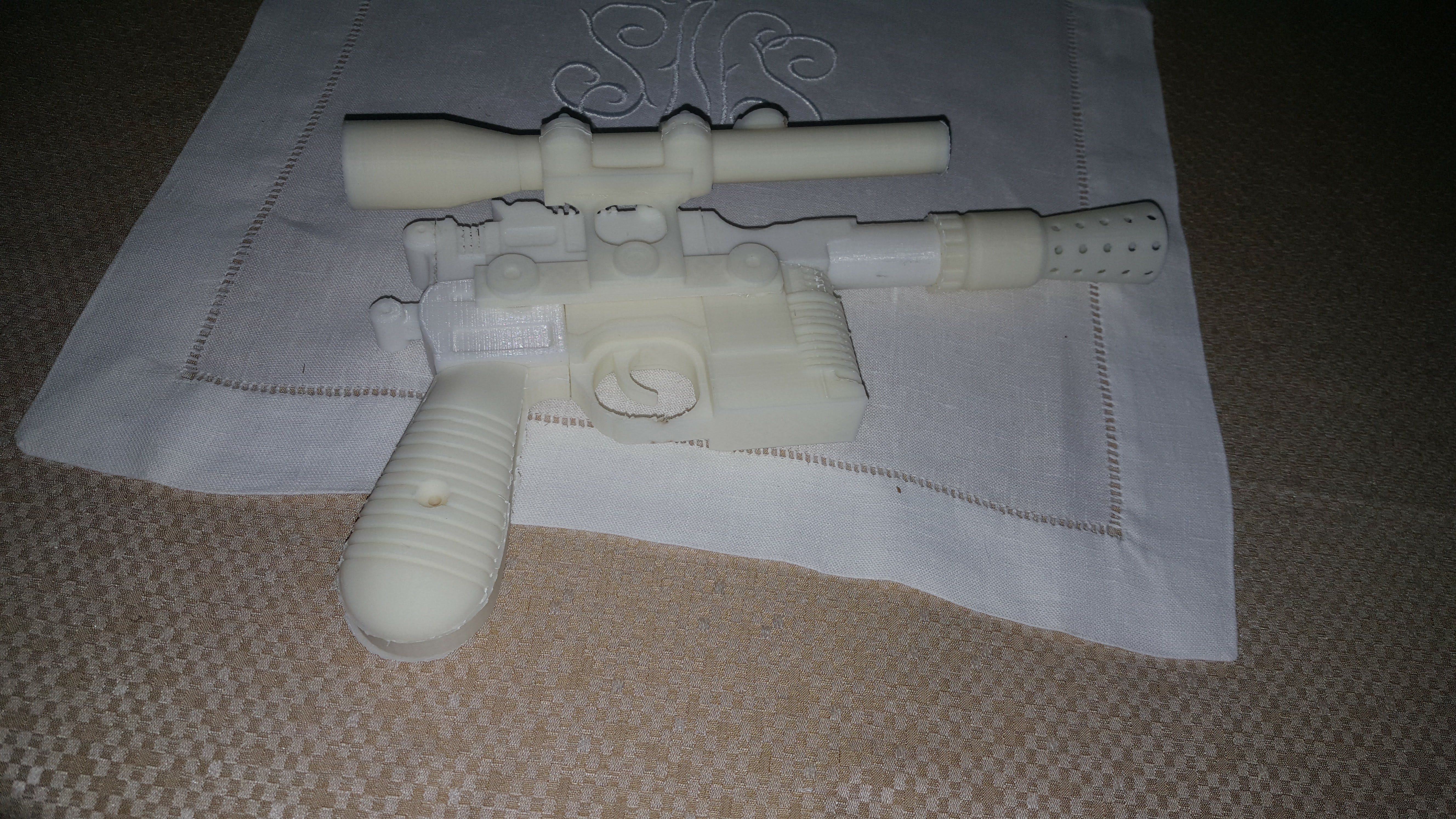

I am a Star Wars fan and in honor of the release of Rogue One I thought I should make Han Solo’s Blaster from the many examples on Thingiverse.
Nah, not this. No metal
I am a scale model builder…but for this it’s for a friend who is more a fan than I am.

You have to paint it though. And, fill in the gaps. I use Squadron putty for my scale models
I build scale armor and for weathering I would paint all black, then dip a brush that has its bristles cut in silver and let it dry a little, then run it over the high spots to simulate wear. The grip parts have to be painted dark brown. Putty fills in the gaps due to shrinkage which can be wet sanded with Emory sticks and a coat of XTC3D before painting gives you a nice surface. Add an LED and some effects in the handle and voila.

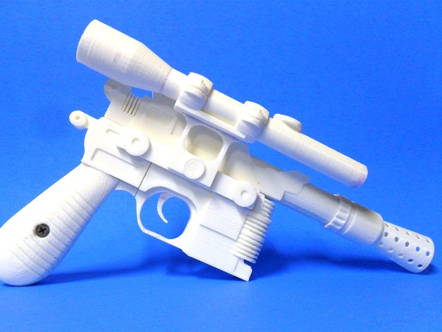

Hi @Samer_Najia which specific model was this on Thingiverse?
@Jon_Gritton it is this one http://www.thingiverse.com/thing:1503525. However I cut the top part in half to make it print easier.
