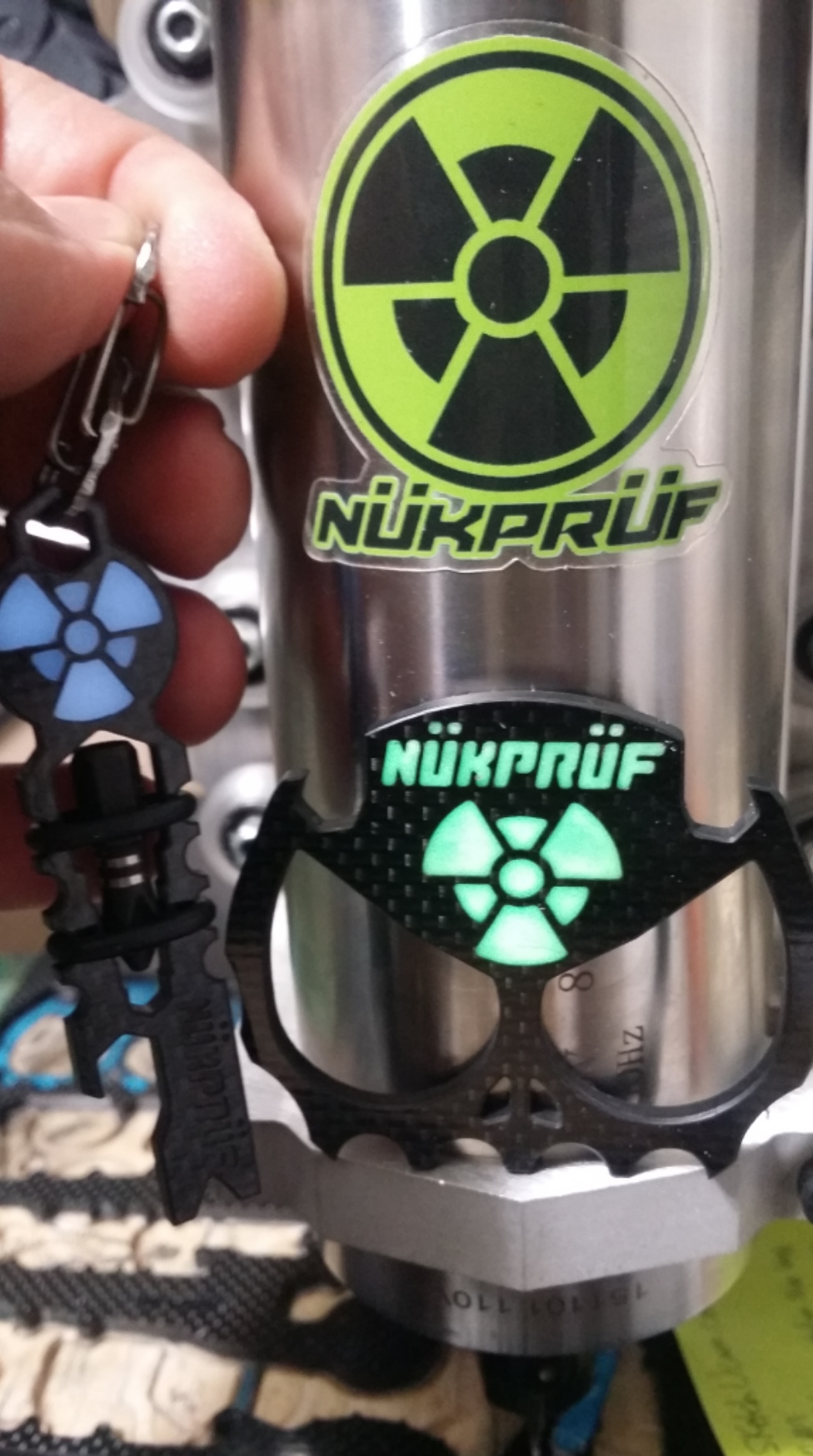

I am absolutely in love with my R7! The blue glow on the left
I am absolutely in love with my R7! The blue glow on the left are inserts and they fit so perfect without having to glue them, I taped them in with a small Jewelers hammer. This machine is so percise when you have it dialled in properly.
What is it an insert for?
That’s cool. What program are you running?
@Randy_Grolemund ​ the inserts are blue glow that go in my logo of that multitool, the glow is pretty much just for the cool factor lol. The multitool has a small pry bar, phillips screwdriver hex bit, wrench sizes from 4mm to 11mm, bottle opener and the glow is good for if you drop your keys in the dark.

Nice inlay work! I have some shell to do soon.
@Colin_Kaminski Thanks! Good luck!

@Colin_Kaminski I used a 1/32 diamond pattern bit from drill bits unlimited to do the cut out of the logo. It was $3-$4. Cutting 100% carbon fiber had to go slow but it worked out good.
