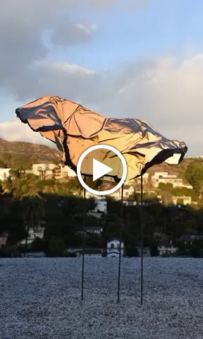

I am an artist based in Los Angeles. I am looking to develop a wearable LED that activates the surfaces of sculptures through different programmable fast changing colors. I know a little code and am learning how to use arduino. It would be great to work with someone that I can take on as a project manager. At the very least I am interested in sourcing a supply list to get things started. Looking to keep the device as small as possible.
The time lapse video was made using an on camera flash/colored gels and shows the experience I would want a user to have in real time with the LED wearable.

Yes, the observer would wear the device on each ear like headphones. The surface of the sculptures are 3M retroreflective fabric so the light needs to be close to the eyes for the experience to occur.
I’ve tested a variety of lights and the effect works best with a light between 10-18 lumens. This light causes a noticeable change even in daylight but obviously more dramatic in dimmer lighting conditions.
