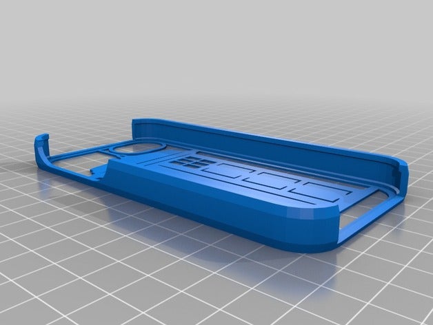

There could be a combination of slicer and calibration problem. As the flowery pattern was so screwed, I turned to a Tardis design. (TARDIS iPhone 5 Case by gunner6666 - Thingiverse) With fewer curves on the bottom layers, they do not screw up as much. But I still got so many bumps that I determined the prints would fail.

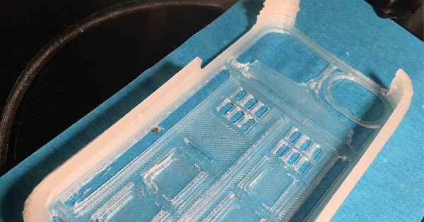

The Tardis case build was more successful but eventually it developed “bumps” at corners. More than that, the build plate drifted - apparently a lot, causing the vertical walls to be unusable. (Even the bottom patterns suffer from drifting.) Most frustratingly, horizontal drifts occurred on both axis. I cannot quite explain the Y-drift, although theoretically drift can happen in either orientation.
