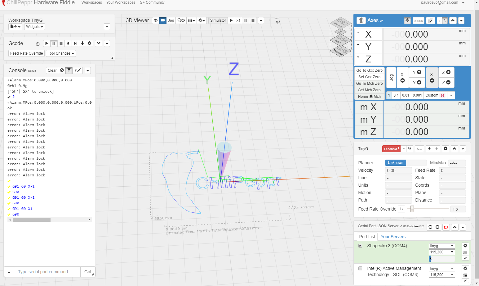

I am attempting to use ChiliPeppr for the first time with my Shapeoko 3. Many of the features look awesome. The Shapeoko has been working well with Carbide Motion. It is running GRBL 0.9.
I have successfully connected to the port with TinyG however I have been unable to get any jog of the machine despite a good deal of fiddling. Based on the Console I seem to be sending Gcode commands but they are not executing. I do note the - error: Alarm lock - which my research indicates the GRBL will send if it can’t find it’s position.
Although I have milling experience I am certainly ignorant of coding and controller manipulation. Hopefully this is something simple.
Attaching screen shot.
