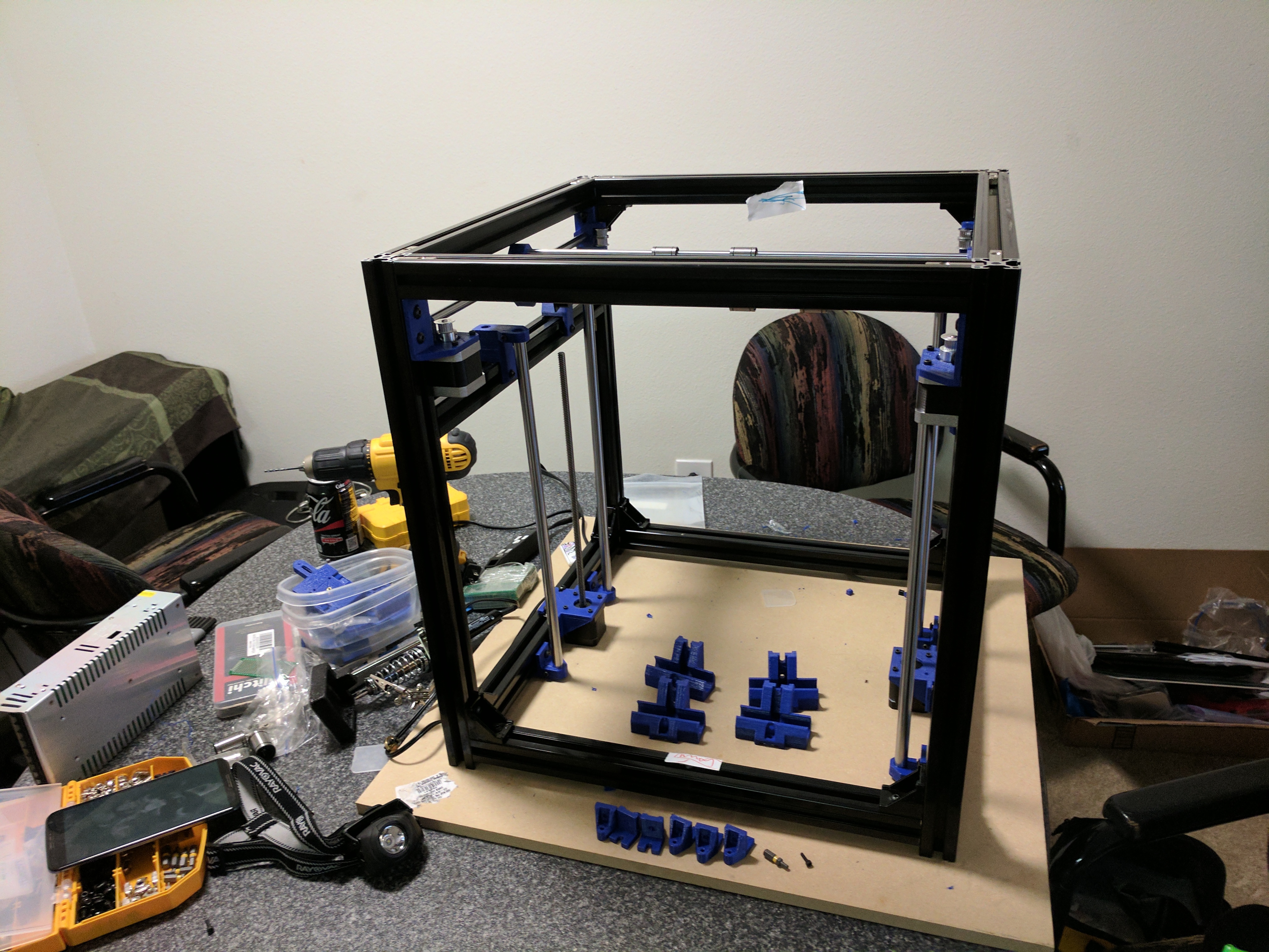

I am building a Hypercube 3d.
I am building a Hypercube 3d. I already have ordered the e3d V6 hot end, I want to add dual extruders. I am looking at the Prometheus System. Before I click buys, is there anything else I should consider using?
