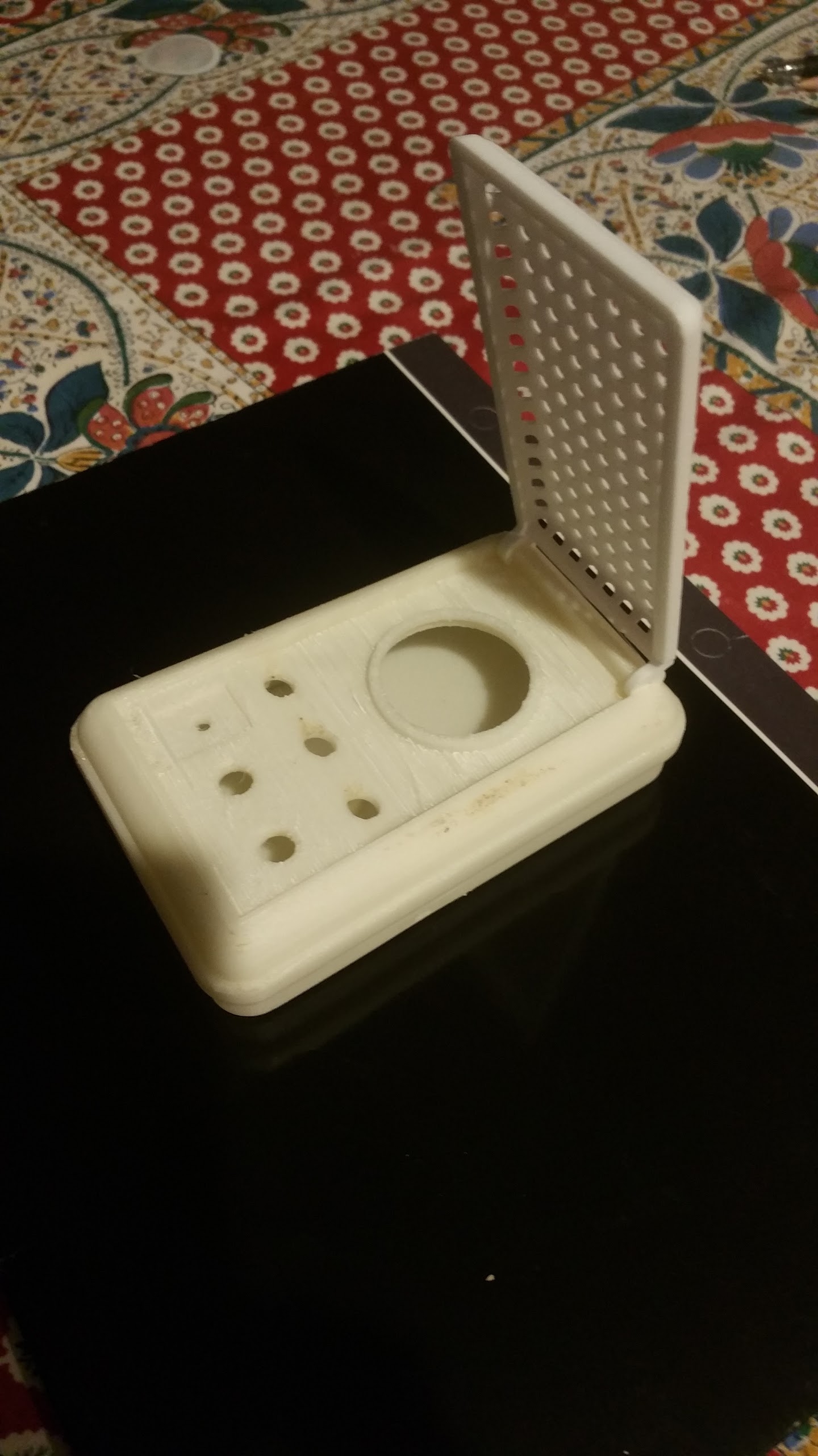

I am building a star Trek TOS Communicator for the Museum of Science Fiction
I am building a star Trek TOS Communicator for the Museum of Science Fiction here in DC. I am bringing it to Escape Velocity next week. What do you think?

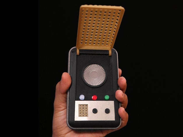

This one is the model on Adafruit. Going to try to add some electronics.
This one then:
Yeah I’ve had that on my list for some time, very nice model.
I am printing on a multiple printers at ‘high’ quality. I will hit the thing with XTC3D to get a perfect finish before painting. Can’t wait!
I’ve really been liking XTC-3D, especially on complex shapes like that one where manual sanding all the little details would be a pain.
I like to sand the part with 120 - 150 grit paper to knock down the really high spots, coat with XTC-3D, sand it again at 200 grit, coat with a high build spray primer, and finally do finish wet sanding at 400 grit (maybe go as high as 800 depending on how fine a finish I’m looking for).
The XTC docs claim you can go from printed part to painting with just the XTC itself, but I found that to be a bit misleading. Maybe if you’re willing (or have the time) to do 2 or 3 coats of XTC, but otherwise I’ve found you still need to do some sanding and filling to really get that perfect look.
I have been hitting it with 2 or 3 coats and then priming and painting and getting some real nice mirror finishes
You letting XTC dry naturally or using heat to speed it up?
The ~24 hour dry time (and to a degree, the cost of the XTC itself) has kept me from doing multiple coats.
Yeah, that’s what I end up doing.
