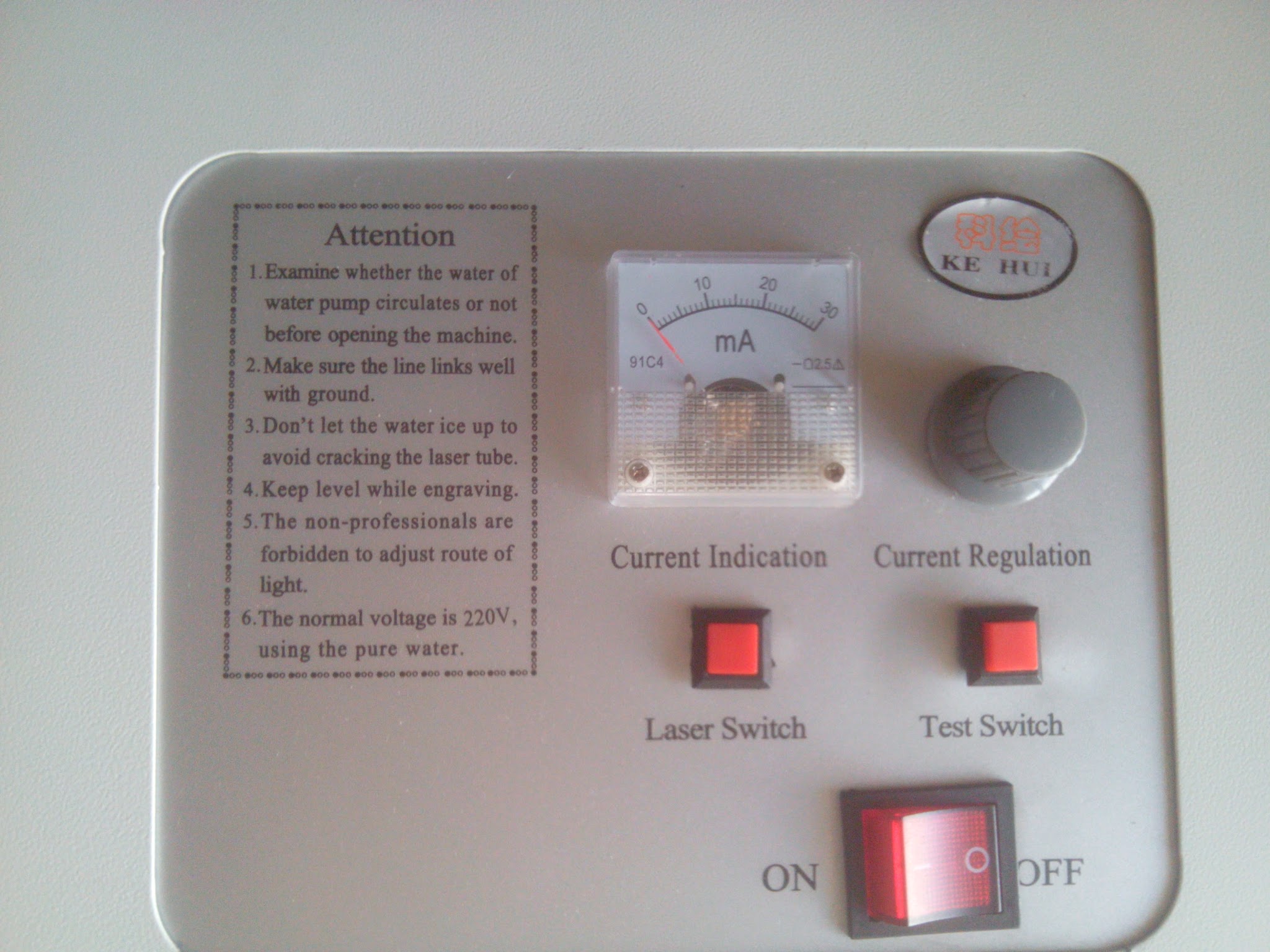

I am desperate. My new K40 doesn’t work. No laser fire and NO ammeter movement, the gantry works ok.

Make sure the laser switch is on.

@irresistiblecam I haven’t had mine for long, so all I can really say is make sure that the switch in the picture (http://i.imgur.com/vngnipp.jpg) is depressed. When the switch is open, the laser will not fire.
quillford thank you for reply. I checked with tests that when the laser switch is down, it is short circuit. I also try to press the red microswitch on power supply board. I am European, Italy.

When you say the laser switch causes a short circuit, what do you mea? Do you mean there’s no resistance between the two poles of the switch? Because that’s normal. My laser switch was pretty bad, I had to mess with it quite a bit to get it to actually engage properly and turn the laser on. Go simple first, make sure that switch is operating properly, you can bypass it by disconnecting the leads to the switch and connecting those wires directly to turn the laser on (unplug the entire device before you do that!)
Also, the laser won’t fire unless you hit the “test” button or run a job, obviously. (sorry, had a history in tech support so I always state the obvious :P)
yes, the resistance between the two poles is zero.
