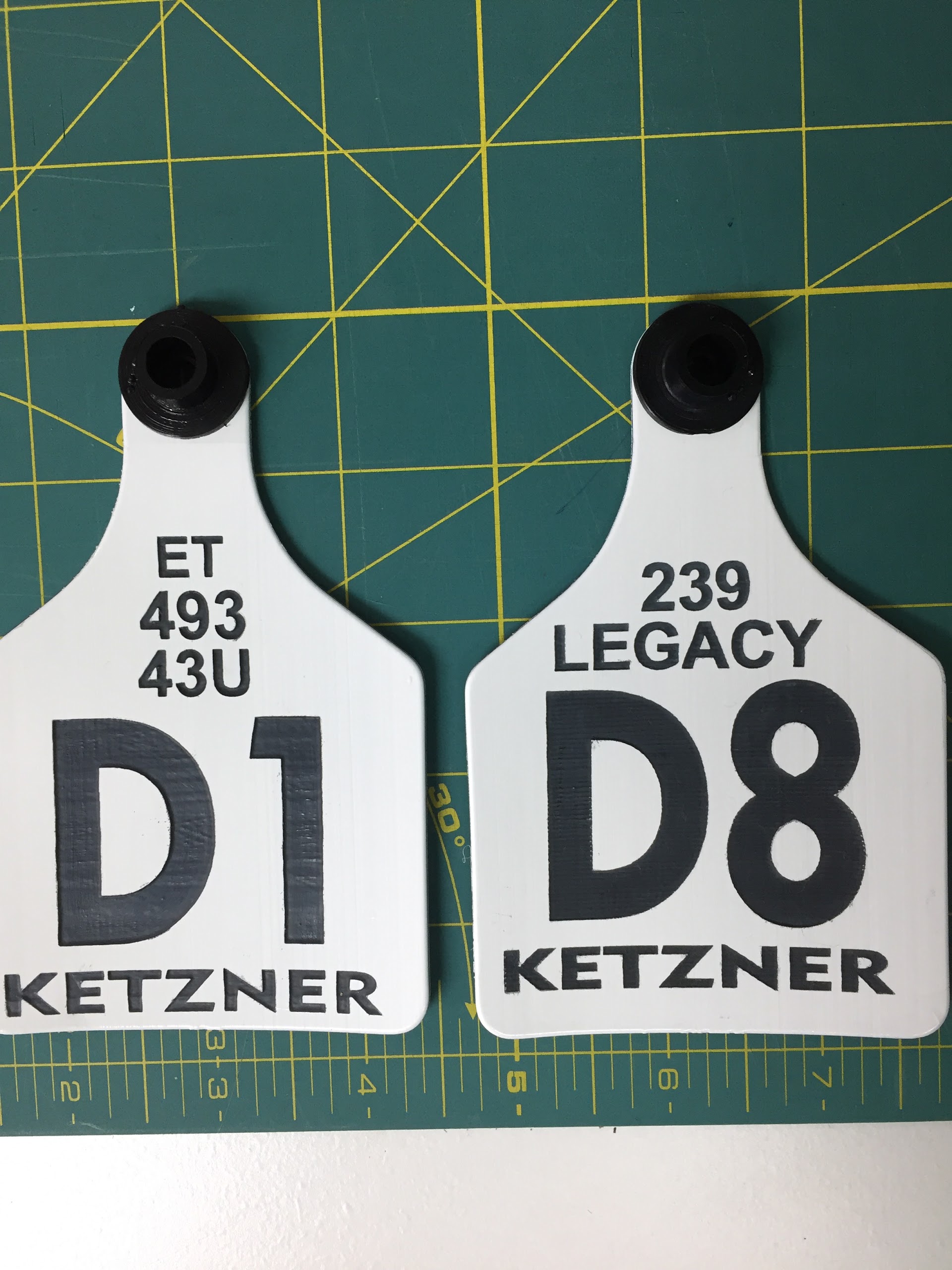

I am engraving cattle tags that have a black center sandwiched between white layers.
I am engraving cattle tags that have a black center sandwiched between white layers. I need help to try and speed up my process. Here are my parameters that I have tried:
Left tag (D1):
Speed 150, pixel 2, steps 1, power 30%
This takes 1 hour 20 minutes for 6 tags
Right tag (D8):
Speed 300mm/S, pixel 1, steps .75, power 75%
    This takes 1 hour but in some places the laser doesn't get through the top white layer, so I have to go mover it again. The other concern is the lines that I have in the D8 tag.
Objective: decrease time because time=$
Smooth the engraving
Any thoughts would be helpful! Thank you!

Thank you! I wasn’t sure what the pixel was actually doing. I thought it made the depth of the engraving.
I will try that!

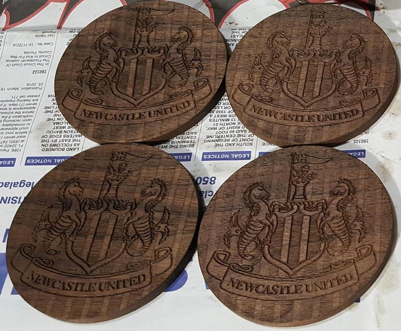

@Kristi_Hawkins It’s a combination of steps, power and speed and the settings are different for every material. I engrave a lot of hickory, walnut and poplar and each one uses different settings. This picture is walnut - I engrave the shallow lines in the background at 5ma and 6 pixels. The logo in the foreground is 12ma and 5 pixels. Both are done at 400mm/s. Wood is probably more forgiving when using higher pixel counts but play with it and see happens.
