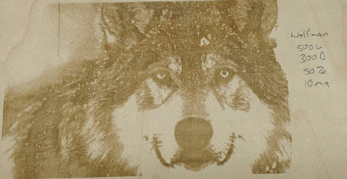

To do grayscales like this easily and to have multi operations like cutting and engraving without having to click a ton of buttons… Being able to control power with software instead of locked in to what the pot is set to
Oh man that is cool. Awesome! For $150 that looks like my next upgrade.
