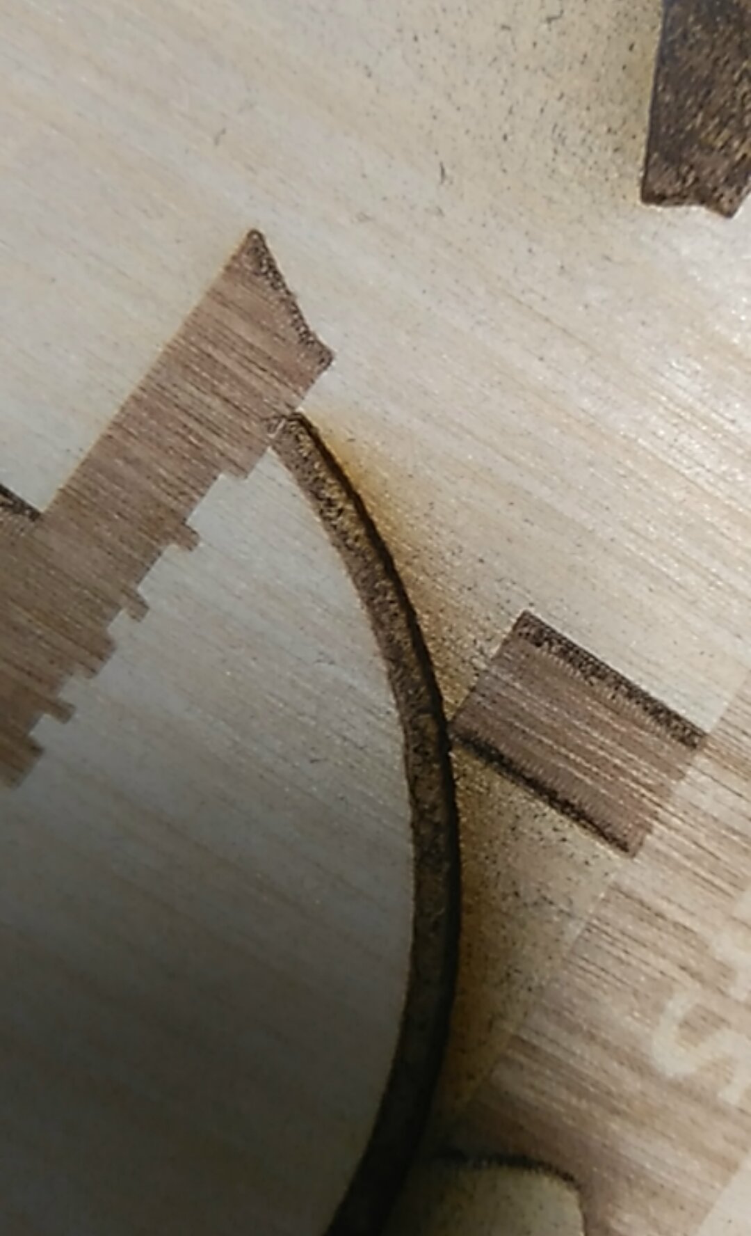

I am having an issue when doing 150mms+ engraves.
I am having an issue when doing 150mms+ engraves. It’s like the laser doesn’t shut off at the edges of the model. Almost like power increases. Here’s is an example of what I mean. It doesn’t do it at 50mms though. I’ve tried burn white on and off.
There’s an option to enable, called “overscan”, which moves the laser past the edge of your design during deceleration, which helps prevent this.
Ok awesome thank you…I’ll check it out in a few!
