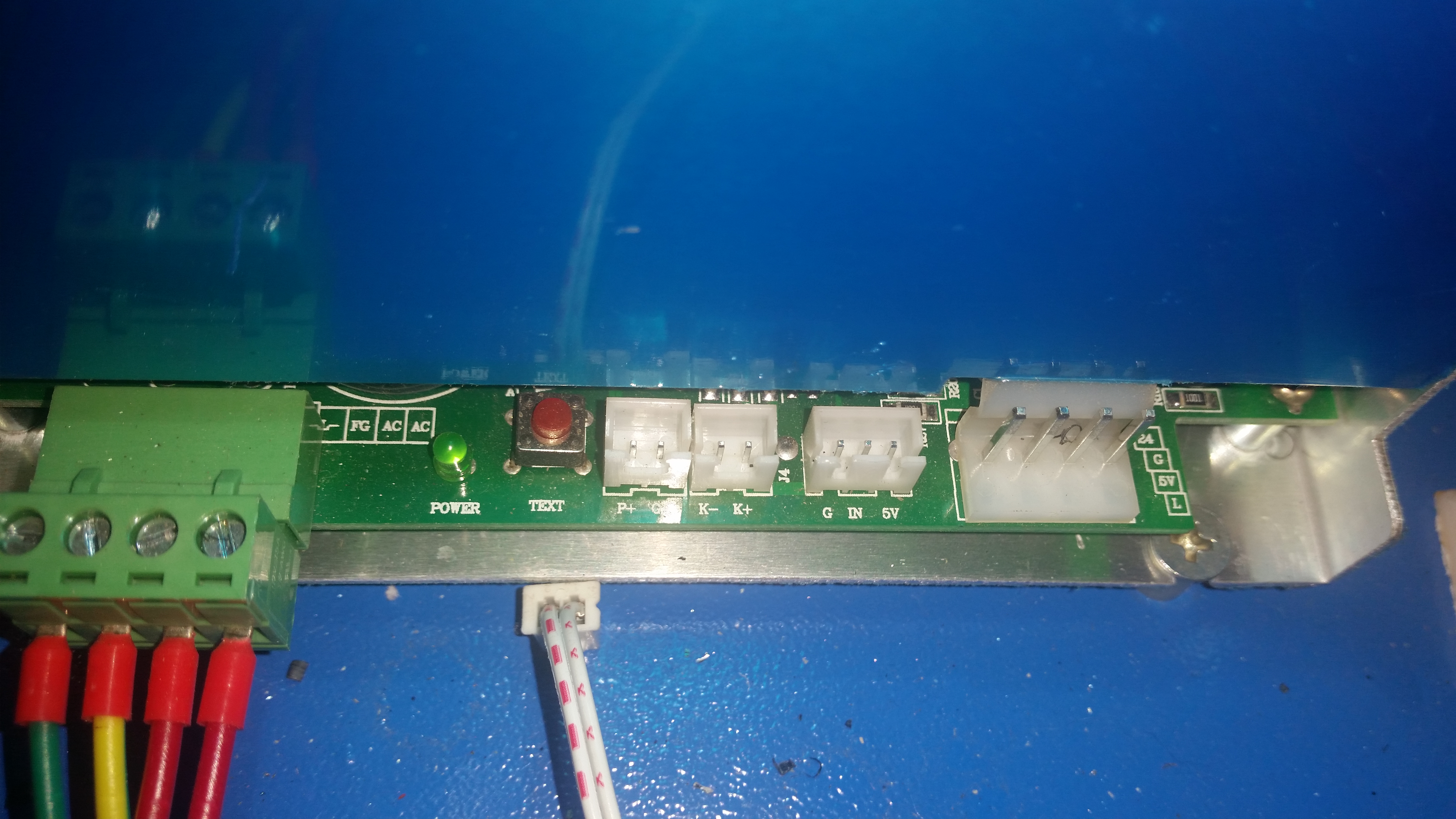

I am having some problem hooking up the power supply to the ramps board. The power supply is myjg40w. Where does D5 and D6 go on the power supply. I looked at the other drawings but they have a different power supply. This is getting connected to a ramps board.
D6 goes to in, D5 should go to K+(That should be the trigger on high pin)
Does L get used?

Check out pic 4 an 5. It should solve your issue for sure.
Thanks. I got it to fire now. Y axis seems to only go in one direction if I hit +or-. X axis is not working. Any suggestions?
