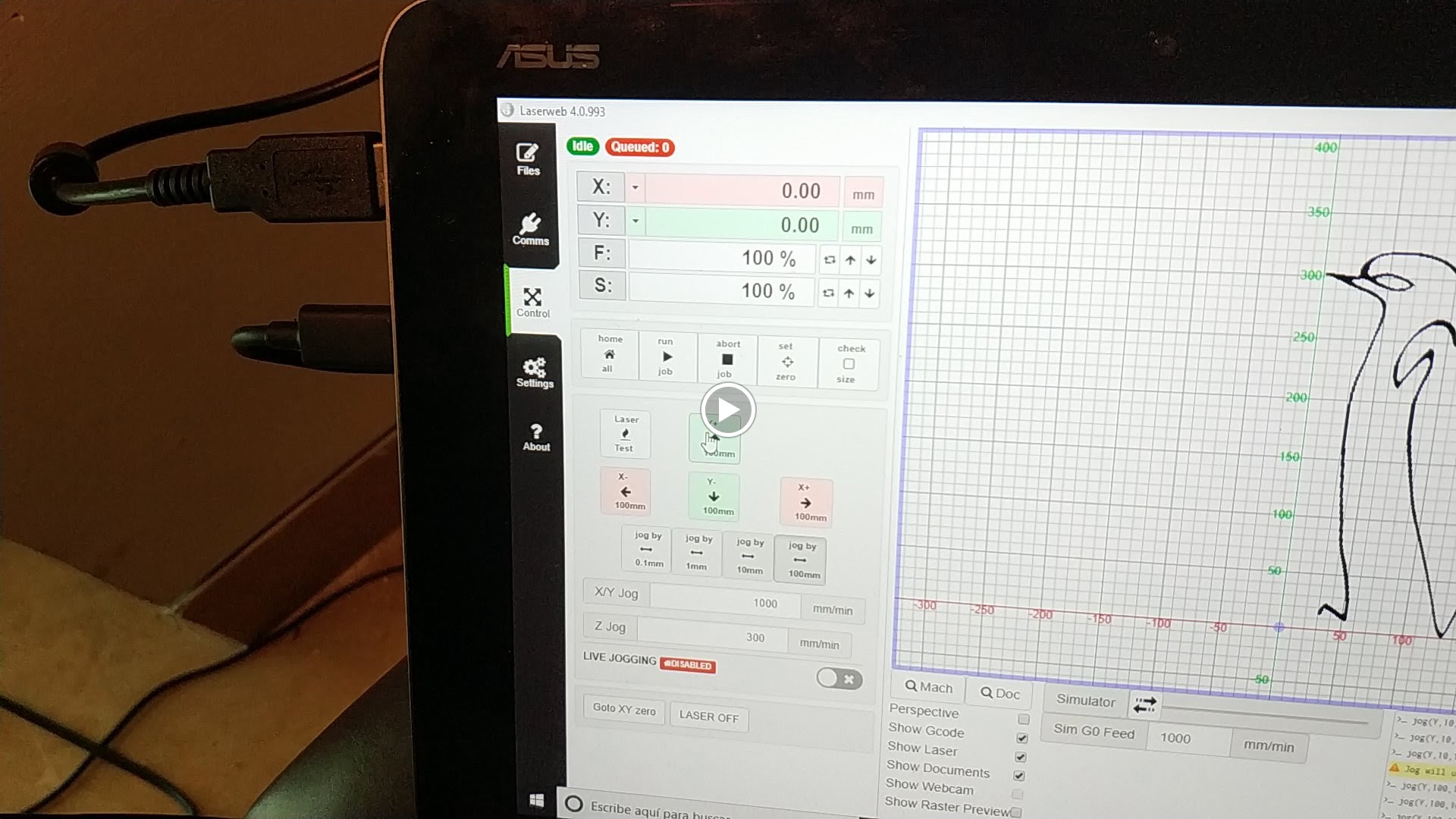

I am having trouble with my Nema 17 motor (Y axis) because is falling down after executing a command. The weight of the gantry is low compared to the theorical capacity of the motor.
