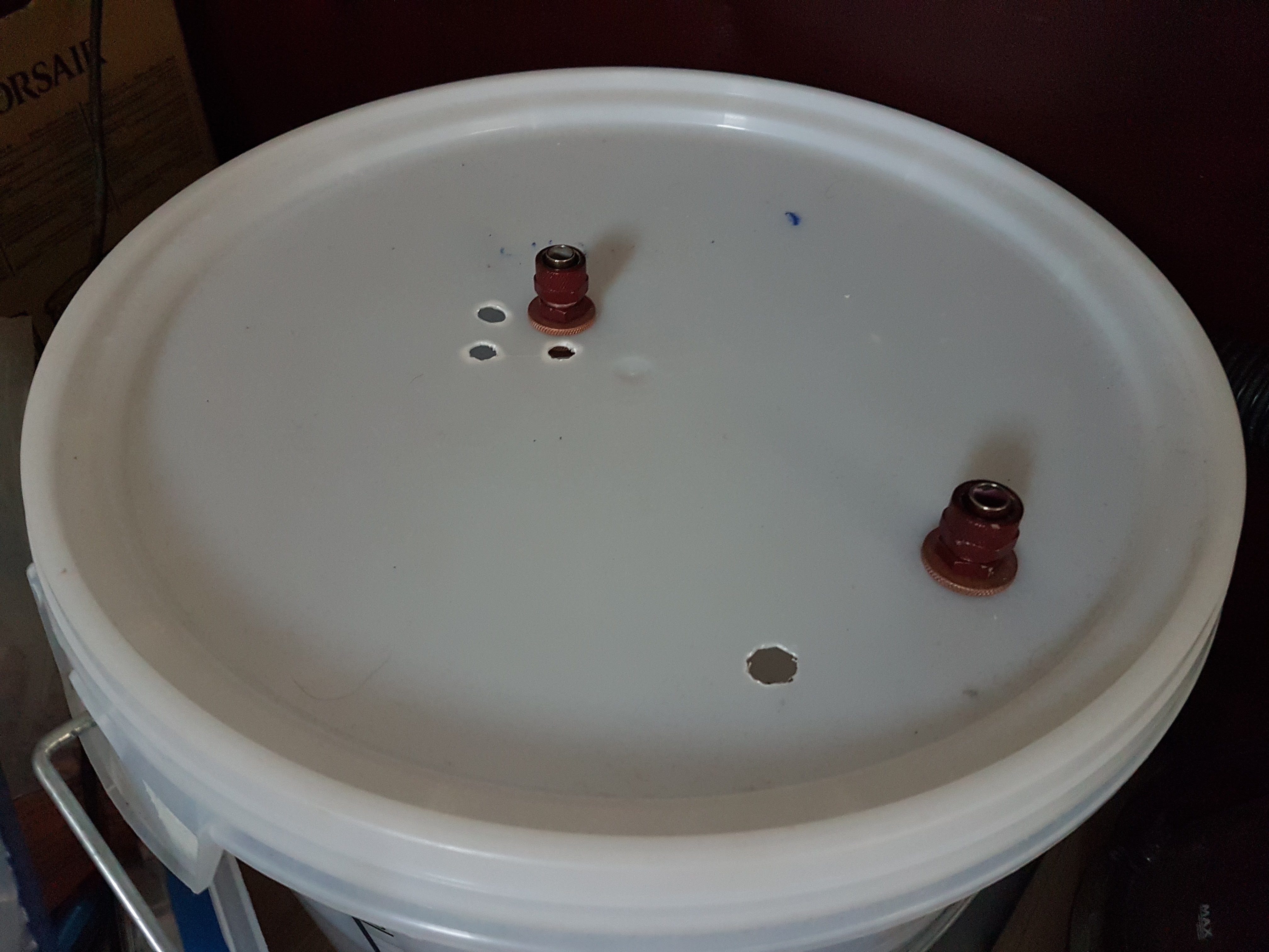

Pic of one of my tanks, it´s completely sealed except for a small hole with a coffee filter to keep air borne dust out. The connectors has a G1/4 thread inside and outside the tank, so i can add compression fittings for the hoses.

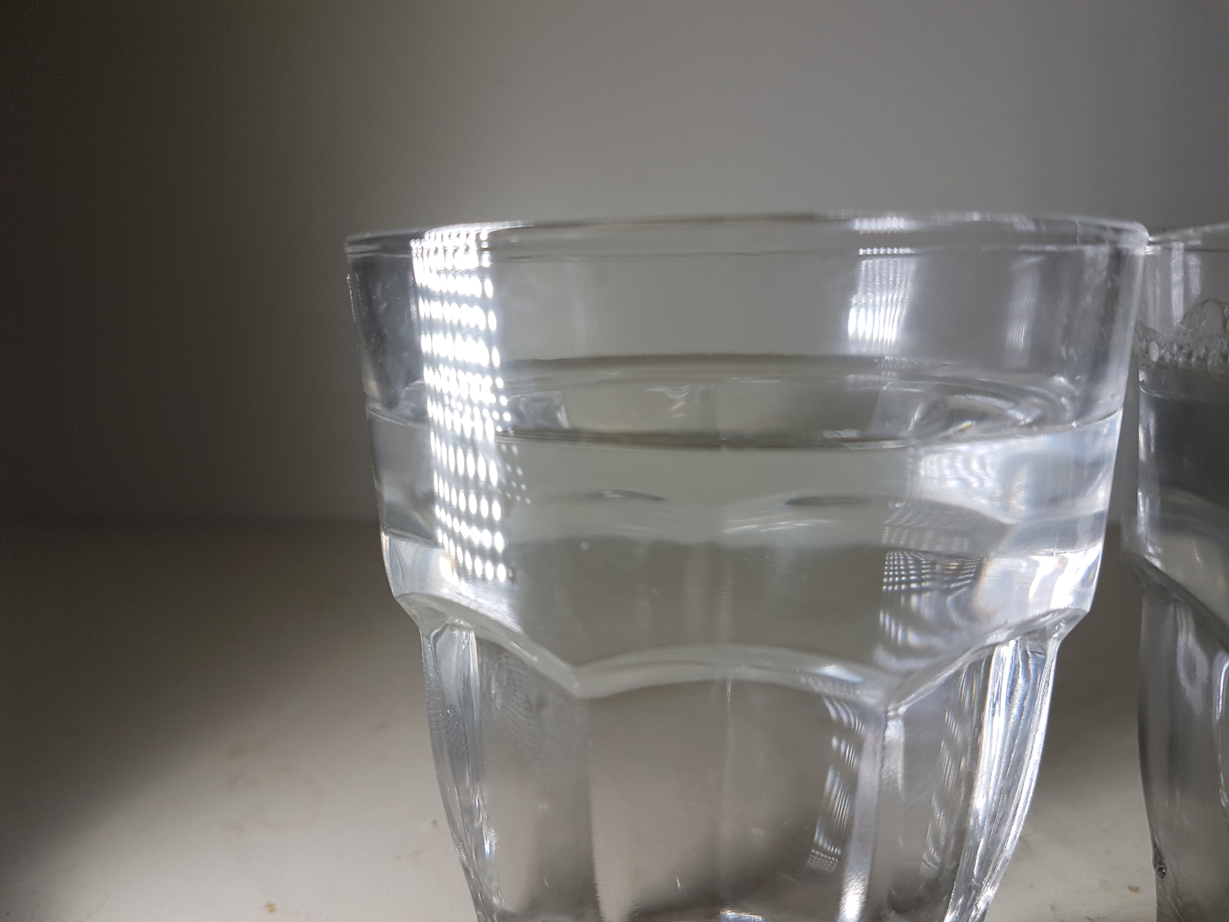

@donkjr How big bubbles do you have? i can see the tiny tiny ones in my mix when i run it by the pump, but the big ones, 3-5mm+ is gone.
Check on the side of the tank too, when it stops curling from the water surface the tension is gone and it should not in a million years be able to create a bubble.
Do a test in a small glass first, do try with another glass with dish soap and water aswell to compare with.
@donkjr Oh wow, that one should be obliterated right away when the surface tension disappears.
Curling, or bending - inside a glass of water the surface tension makes the water creep up a bit on the edge around the wall, when the surface tension lowers this effect stops - see pic of a glass of regular distilled water, where the edge “curling/bending” can be seen.
In my tank, the water is 100% flat and does not bend like this.
