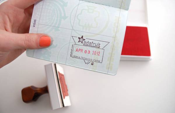

@cprezzi Look at a rubber stamp. There is the design, then under the design is an angled build up that supports the design so that it doesn’t break. The process is described here for whatever software adafruit was using.
