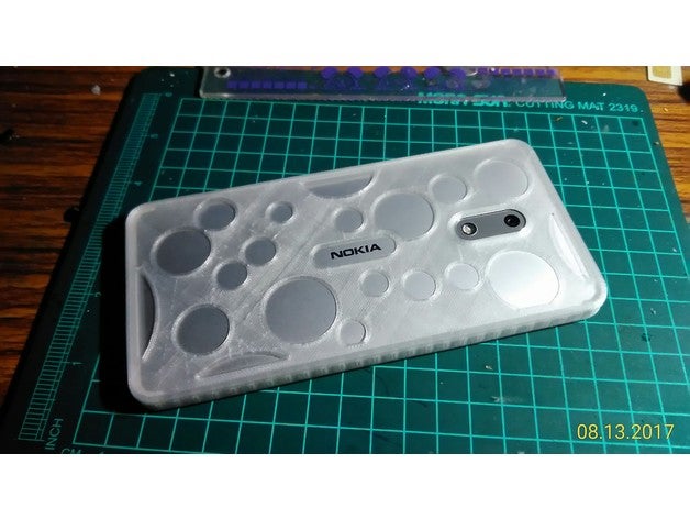

i like make some useful things with 3d printer, that is one of my design, i use flixble TPU to print, so beautyful and useful.
