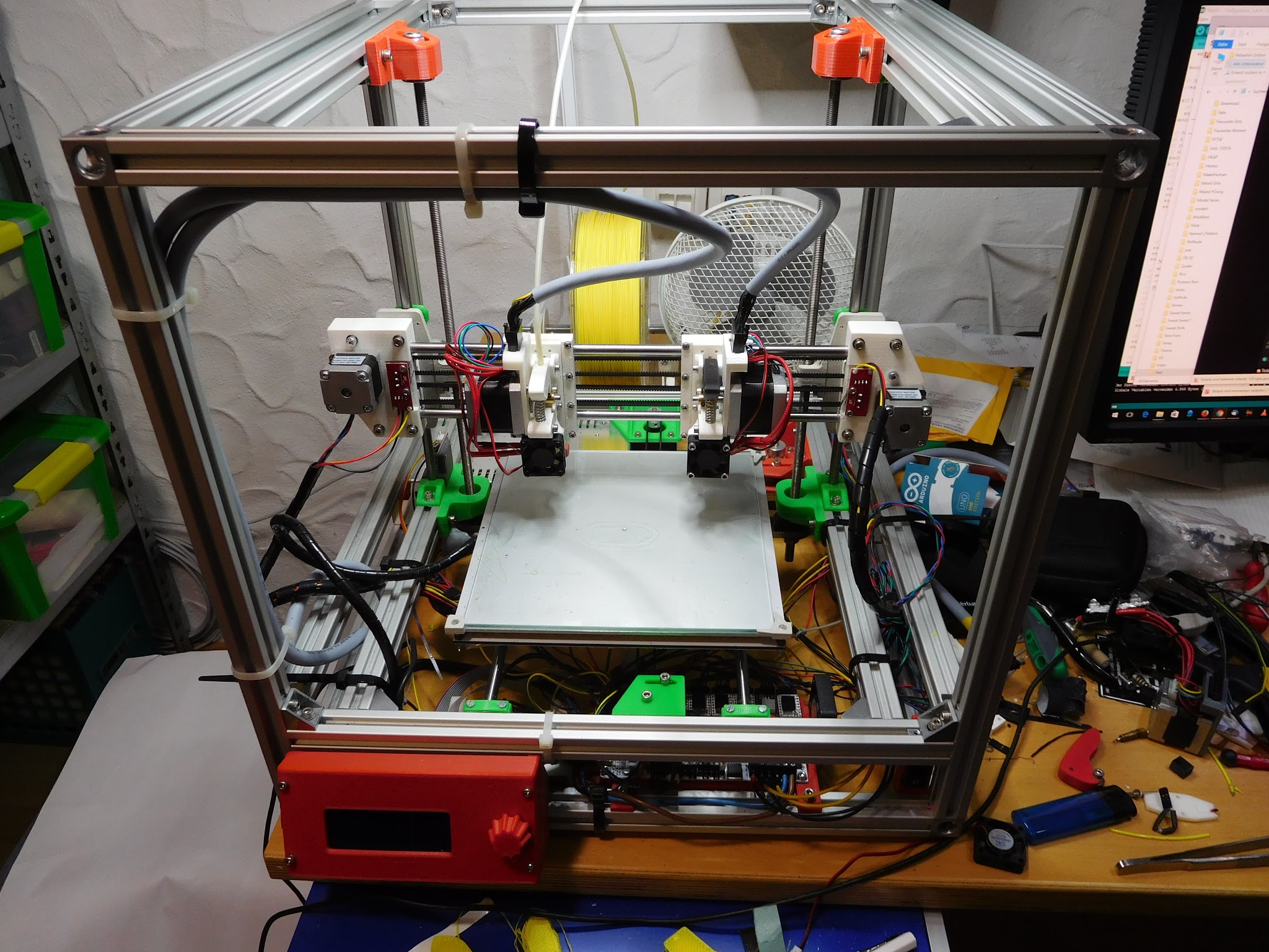

I am looking for a Firmware that supports dual X Carriages. In theory Marlin does the job, but it has some bugs that render it useless for Dual X. I have a completely built machine sitting here that i can not fully use now

No, completely seperate extruder movements and control is neccesary. I don’t want a copy machine, but something that can use two different materials in quick succession. Marlin offers that, but sadly it’s to buggy.

What are the bugs preventing you from using Marlin?
@Oystein_Krog The main problem is that the initial positioning of the second X carriage is not determined correctly. Homing works fine for both carriages, but as soon as you try any kind of movement for X2 it tries to got further in + direction, even though it has already hit x-max. It is open as issue 2861 on nGithub.
Why didn’t you get 2 heads and 1 carriage?
A single head has less mass and can be moved faster. Also you don’t need to cool them down to prevent ooze while the other is printing. Also you could use completely different extrusion setups for each. Carriage, let’s say a super light bowden setup for fast ABS/PLA printing and a heavier direct extruder for elastic filament that prints at lower speed.
