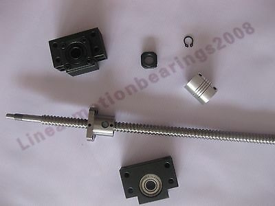

I was going to go with this BF10:

OR some combo like this.
Anybody have any Pro’s or Con’s for a setup like this?

The BK/BF pair is the thrust (A/C) bearing.

Two Z-Axis ballscrews, with ballnuts, for ~$70 is the same cost as just the thrust bearings and bearing blocks from the Eustathios BOM. And the support block replaces the thrust bearing. Unless I’m missing something?
