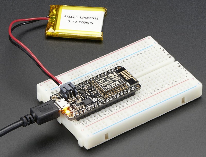

My favourite ESP hardware is the Feather Huzzah
