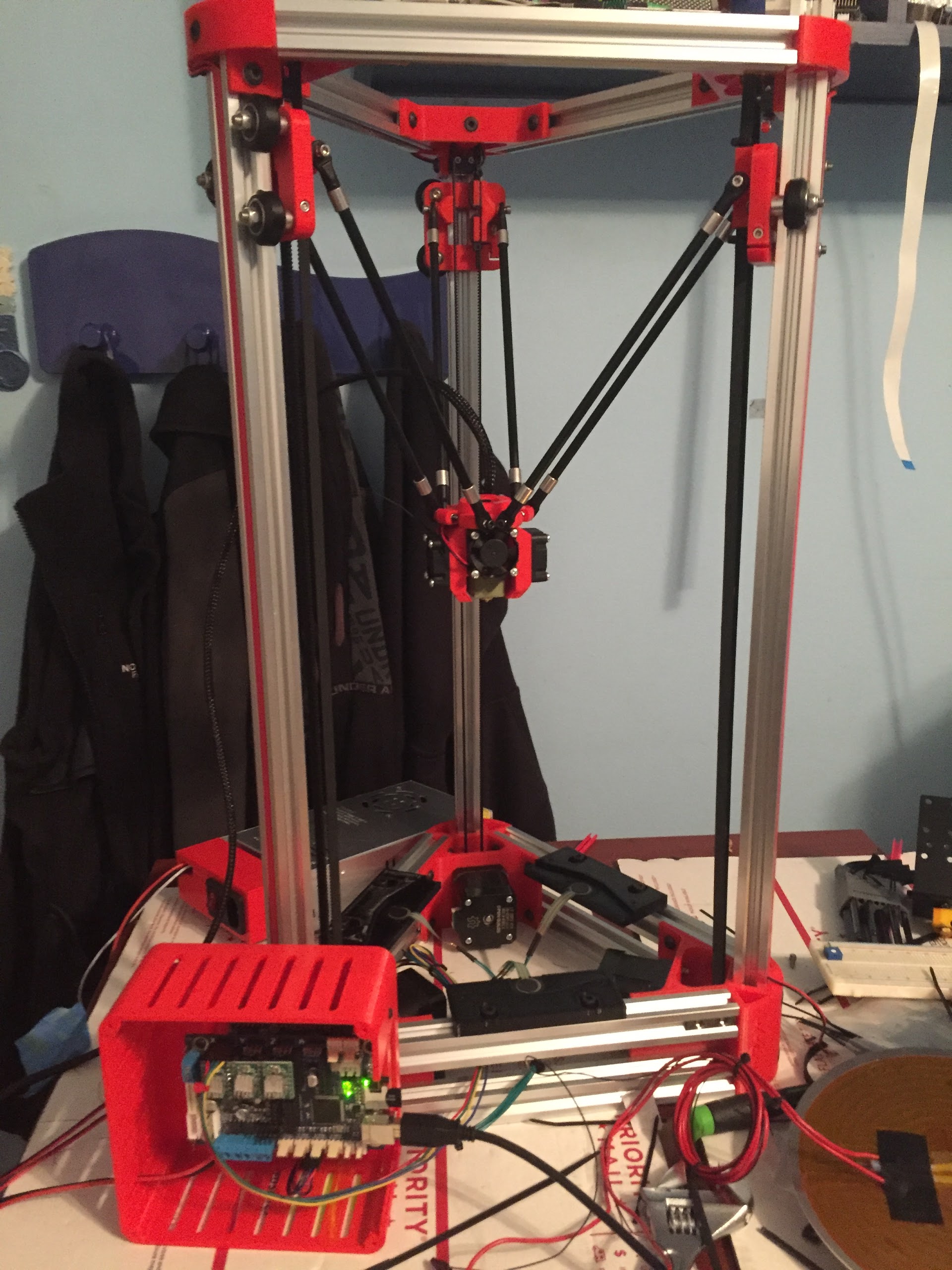

Self built mini kossel vslot, ultibots design. Wiring it up now.
