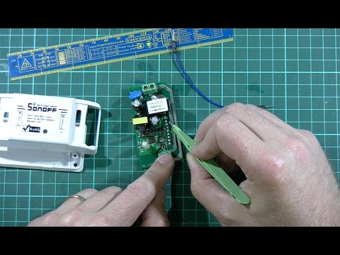

This video is pretty good on sonoff usage and secrets. It’s a little long but worth it.
