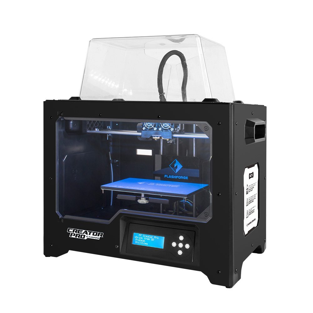

I am new to 3D printing and I am looking to purchase a printer.I
I am new to 3D printing and I am looking to purchase a printer.I am developing a new product and I need to print off a component to ensure it works and the dimensions are correct .Is there a suitable printer that could produce durable parts for a small production run . The plastic part will connect 3 wheel pulley bearings together. But will not be visible once installed. Loads will not be excessive . I am presently looking at the
New Flashforge creator pro 3D Printer with upgraded design.
or do I need to go for something like
Dremel 3D45 DIGILAB 3D Printer
Or is it the case that 3D printing is not suitable for commercial use.
If this is the case I will be tempted to go for the creator
Any advise would be gratefully received
Thanks in advance
Frank Nolan

Hi @Frank_Nolan firstly, I’d agree with @Rich_Brown that it’d be a good idea to get a few pieces printed by a service first so you can see if 3D printing is even a suitable method for producing these parts. Any half decent printer is going to cost you $500 and the likes of the FF Pro around $700, and that’s quite a lot of 3rd party 3D printing - possibly even the cost of your entire run. If you buy a printer and it doesn’t work out, you’ll have lost a bunch of cash in the resale.
I don’t really agree that the FF Pro is a “poor substitute” for the Prusa i3. I have both machines and my FF Pro is more than capable of producing prints to the same quality as the Prusa - and has the added advantage of being enclosed.
Neither am I convinced you need to spend a lot of money on something like the BCN Sigma. If your parts are simple, and don’t require “exotic” materials, then there are many sub-$1000 printers that’ll probably produce parts that are fine for your needs.
However, I’ll say again that in my opinion your best option is to first get a few parts printed by a service, and test them.
