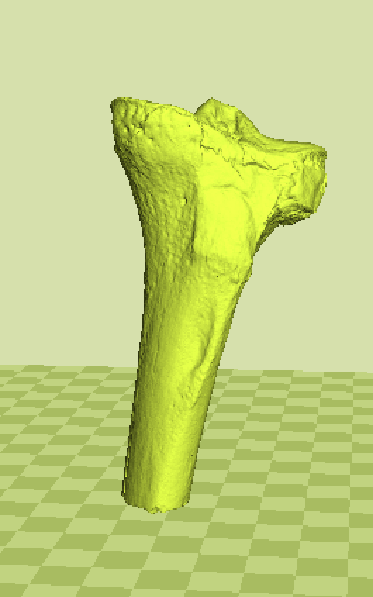

I am new to 3d printing. I have a bone replica that I’m trying to print, but i an unable to print due to the surface area of the bone. How can I be able to print a Tibia bone>

From the images you supplied we can see that you will require supports. If the print its self is too larger then we would suggest cutting the model into sections and after printing them all out glueing them together. This may also reduce the need for supports.

I’m no expert. But my first thought is to lay it horizontally and use supports.

The sliding bed makes that part tougher to build than it needs to be, the leverage and high center of mass would try to dislodge it from the table as the table shakes Y+ and Y-. I would second placing the part horizontally. Either whole with supports or half above half below, then flip it, glue the halves together.
I printed a downsized set of more recent human leg bones a couple years ago Meshlab will reduce the stl file size if you need it, then netfabb (either download or online) can reorient it to horizontal. You’ll still need support but try rotating the bone sections to minimize the amount of support removal you’ll need to do.
