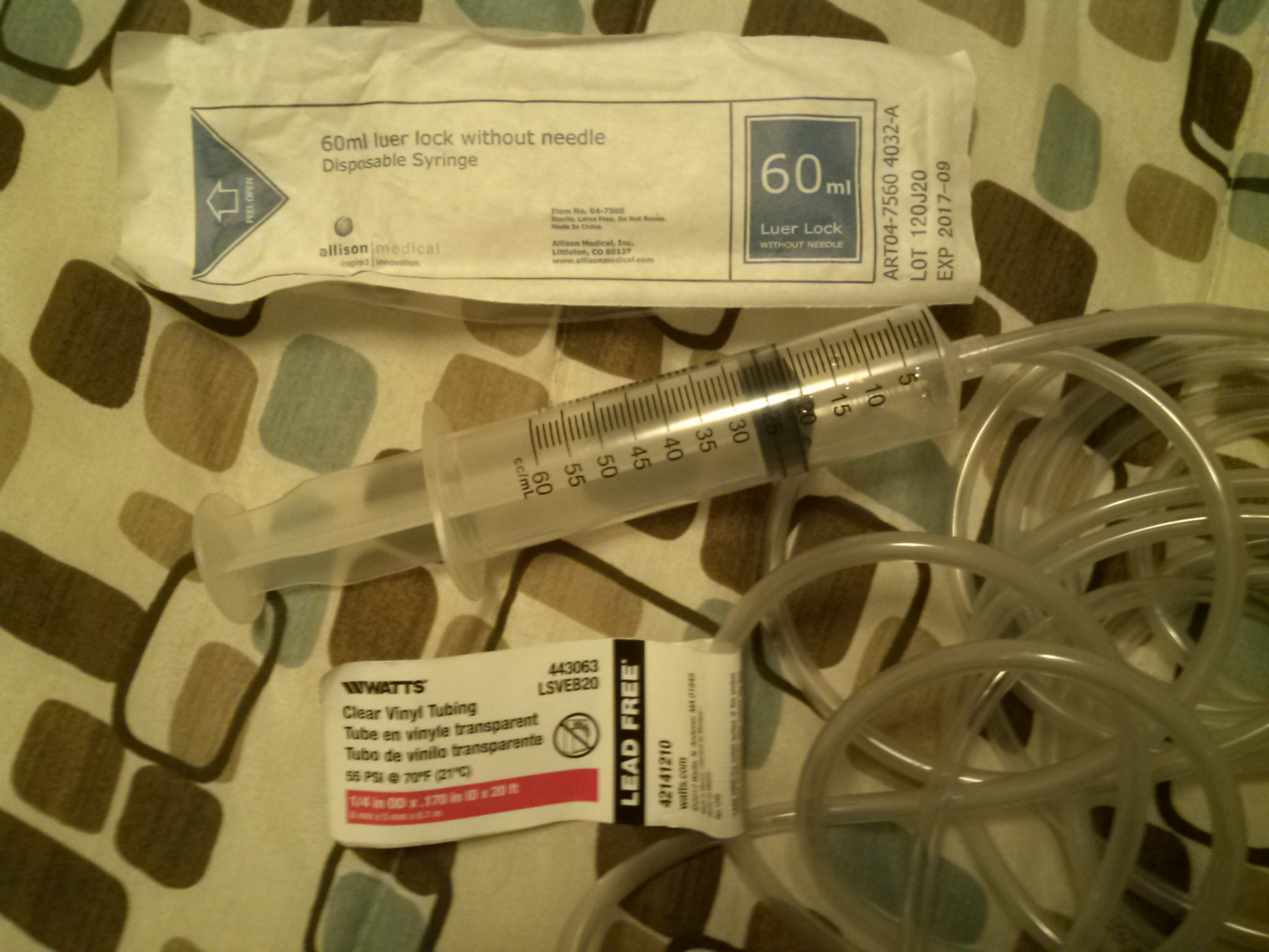

I am not sure, but I think this may work for my delta printer. I think I need a piece to let me hook up a 2nd tube for pulling liquids into the syringe though. At any rate, it is nice how this tubing from Lowes fits the 60cc syringe from Farm and Home Supply.
What are you planning to squeeze through there?
A 2-way valve might work for pulling in liquids. I know we had them when I was a military medic; not sure if they’re readily available for vet use.
@Wayne_Friedt a binding agent, a resin, clay…I am not exactly sure yet, to tell the truth.
I just thought of something funny. if the hose ends up being long enough, a full 60cc of whatever might all fit within the tube itself. If that is the case, I could remove the nozzle and the tube and rinse it out and blow air through it to clean it without actually removing the extruder itself.
