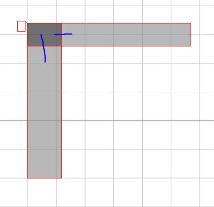

When i load in the cut svg and generate the gcode it wants to cut the intersects. It does show as a two part peace. I just couldn’t figure it out how i can say where to cut and where not.
Also which option task do i have to select for the BED engraving svg file ?
if the components you want to separate are different colors in the svg you can filter by stroke color. use the simulate slider to verify without wasting material.
if you use inkscape try selcting the 2 rectangles and clicking object-combine path that should merge them. or if that doesnt work then double click on them to see the actual noted and delets the sections you no longer want. Also a relative CAD noob here, the undo button is your friend
