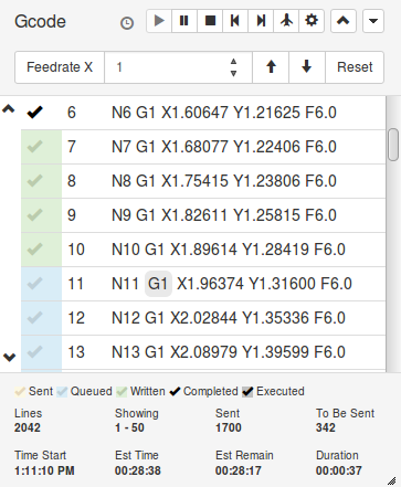

I am successfully using ChiliPeppr to jog my X-Carve CNC, but when running pasted gcode it pauses after 10 lines. The code keeps buffering, but the machine will not move more unless I click Cycle Start “~”. Even then it will only execute one line before pausing again. Any thoughts on what might be the problem?

What version of spjs? Grbl or TinyG? Full screenshots help
Sorry, forgot to add those details… spjs v1.86 and GRBLv0.9j
Full screenshot: https://photos.google.com/share/AF1QipNOb50Z5JoihpR4fZkegDutYzol3wEUVeK3vXcHVlCbnD-PNMaMl3hjCqIEMIC-3w?key=RW9MNFJlNmtoTHRVdE5QZUdGOWoxaGF4QXFjOHJ3
I tried a few scripts and it always stops after the first several lines.
It appears that your Grbl device is frozen. Have you issued a reset? Grbl loves to put itself into an alarm state. When I look at your stats it appears you’ve filled up your 128 bytes that are allowed to be sent. Grbl sends an OK when it has processed a line. I’m not seeing any “OK” coming back. That indicates it’s in an alarm state. However, I’m seeing “idle” in the Grbl widget so that makes it feel frozen. What if you just reset everything especially the Arduino Uno?
That makes sense, but is weird that it is not saying “alarm state” as I have seen before with other issues. Totally new to this though, so that doesn’t mean it isn’t obvious to someone more experienced! I reset the Arduino and that helped some; I made it through 21 lines this time. Screenshot: https://photos.google.com/share/AF1QipMiH9cX3AdhCX-Pn_1ncFQu5lJVi6-gjLsQdFpXW-7W7zKBnDiPLM-hGAqVkg0HLg?key=bG93X1QxY1BEWWJ0N3NVRFFiekg1LXlWVFBwVm1n

Hmm. I’m still not seeing any “ok” responses come back per your screenshot. Your GRBL device is just plain not sending data back. Could you possibly try SPJS 1.83 just as a test case? 1.83 uses a different serial library that may work better/different on Linux and I see you are on Linux.
