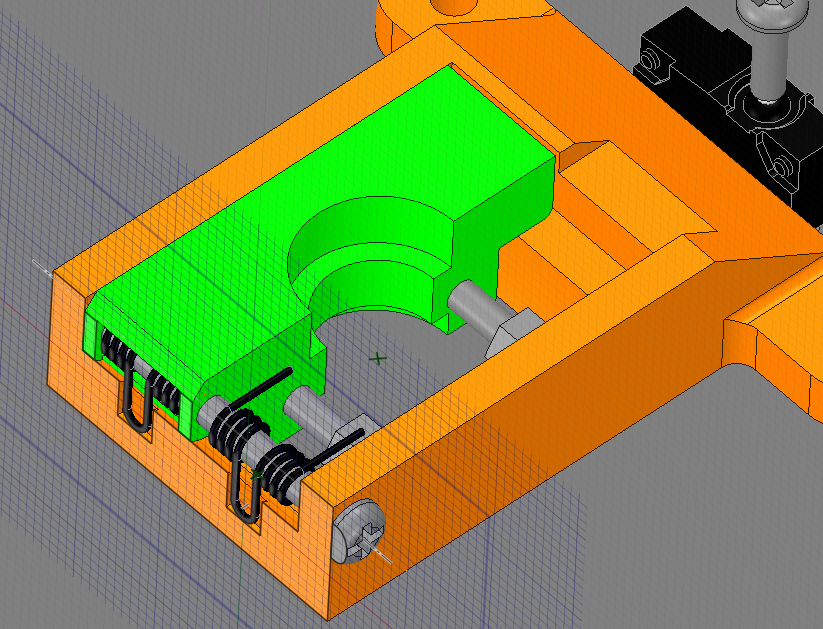

Now about the design of the “hinge”, I have pretty much decided on a “snow plough”-type https://is.gd/Ey4moY- torsion spring (or even the clothes clamp type) to bring back the hinge into position. Do you guys have any experience embedding torsion springs into the printed plastic? Would the thin wires eat into the plastic fast?
Here’s an example of what I am thinking of:
(but this is quite off-topic for this post so i might spin this off to new post))

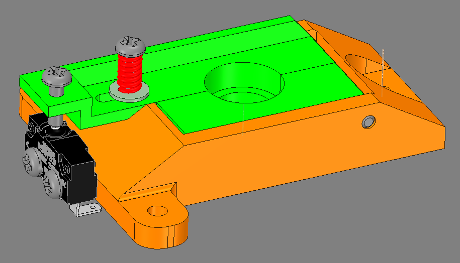

Ok, wiring microswitches aside, I have reverted the design to an easier -but again less elegant
- compression spring loading for the hotend mount / lever:
