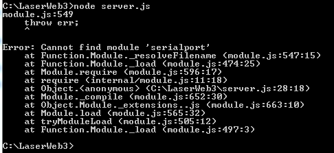

I am trying to install LaserWeb3 and while in the command prompt, I enter node server.js in the LaserWeb3 directory and get the following error. What am I doing wrong?
Well, to begin you’re using Laserweb 3… All development has moved to Laserweb 4 branch…
Secondly, it looks like you’re missing a module… Now it may actually be installed but missing the correct JAVA path environment variables…

You’re missing SerialPort. Try: npm i -g serialport
