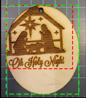

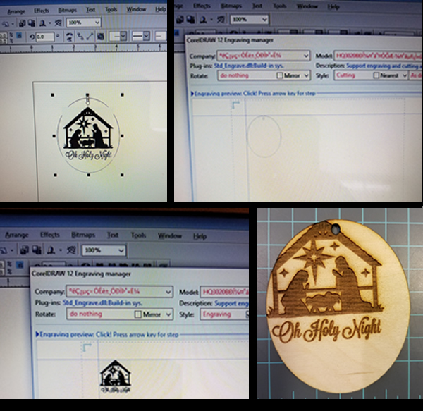

I am using coreldraw 12 with the K40 Laser and I am having trouble figuring out how to line up the designs. I have attached the picture, but I am toying around with an ornament and I put the design on and then draw the outline circle to cut in corel draw. I then send the design to the laser to engrave, and then send the circle to the laser to cut. I guess when I send it, it lines each part op to the top left instead of keeping it in the position it was in the design. Can some one give me some help on how to do this, I am obviously overlooking something. You can see the results
the problem I encountered as well: Corel will position everything on the top left corner (more precise the corner you specified in the LaserDraw pugin).
Your engraving is smaller than your circle/cut and so both will be send to the corner, ruining your workpiece.
Normally I just engrave the cut as well or place a tiny square or dot (some 0,01mm) on the top left of the project which will be cut and engraved and everything is then relative to this ‘zero point’.

You can always reference your drawing in LaserDRW by center instead of top left corner. Everything should line up fine.
Just helped someone with this today https://plus.google.com/u/0/105465271425419072597/posts/LZJWAbTeqnL
Put a small mark line top left in both for a start spot for laser
@HalfNormal but if you center align, you will have the same issue, only this time moved to the center. This works for centered designs though.
The only way I figured out is harcoding a common origin marker on both engraving an cutting design/layer. A box will do the trick as well, but will extend the engraving time (depending on the dseign)
You also have to remember to put the pixel/box in the design and make it white so it will not engrave/cut. Most engrave/cut designs are centered. Yes not all but most.
Thanks guys, I have had since that I designed in a program and imported in and just made two images the same size and did it that way. I was hoping for an easier way I guess.
The simple solution is to center everything at the same point. Find the center of your circle. Place the center of your design at the same point. Cut or engrave off that center point.
