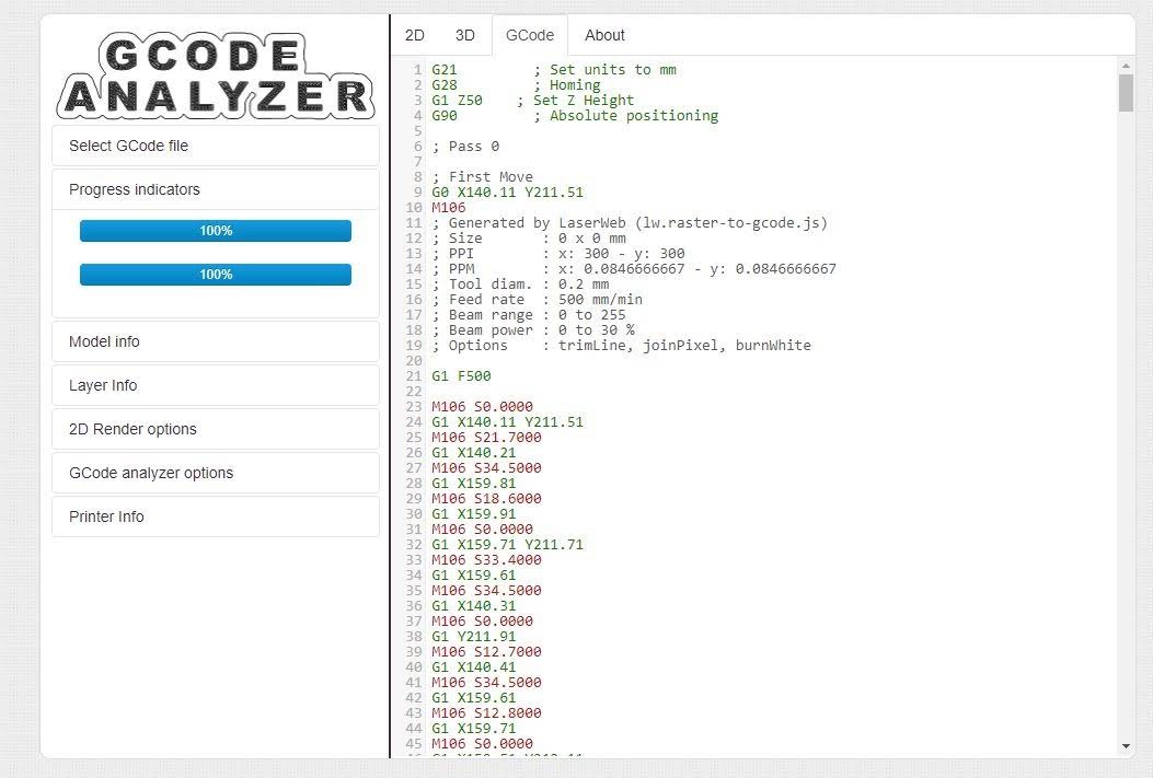

Is it normal for the Gcode to turn it off so often? Is there a setting I can change to prevent all of the M106 S0 commands?
