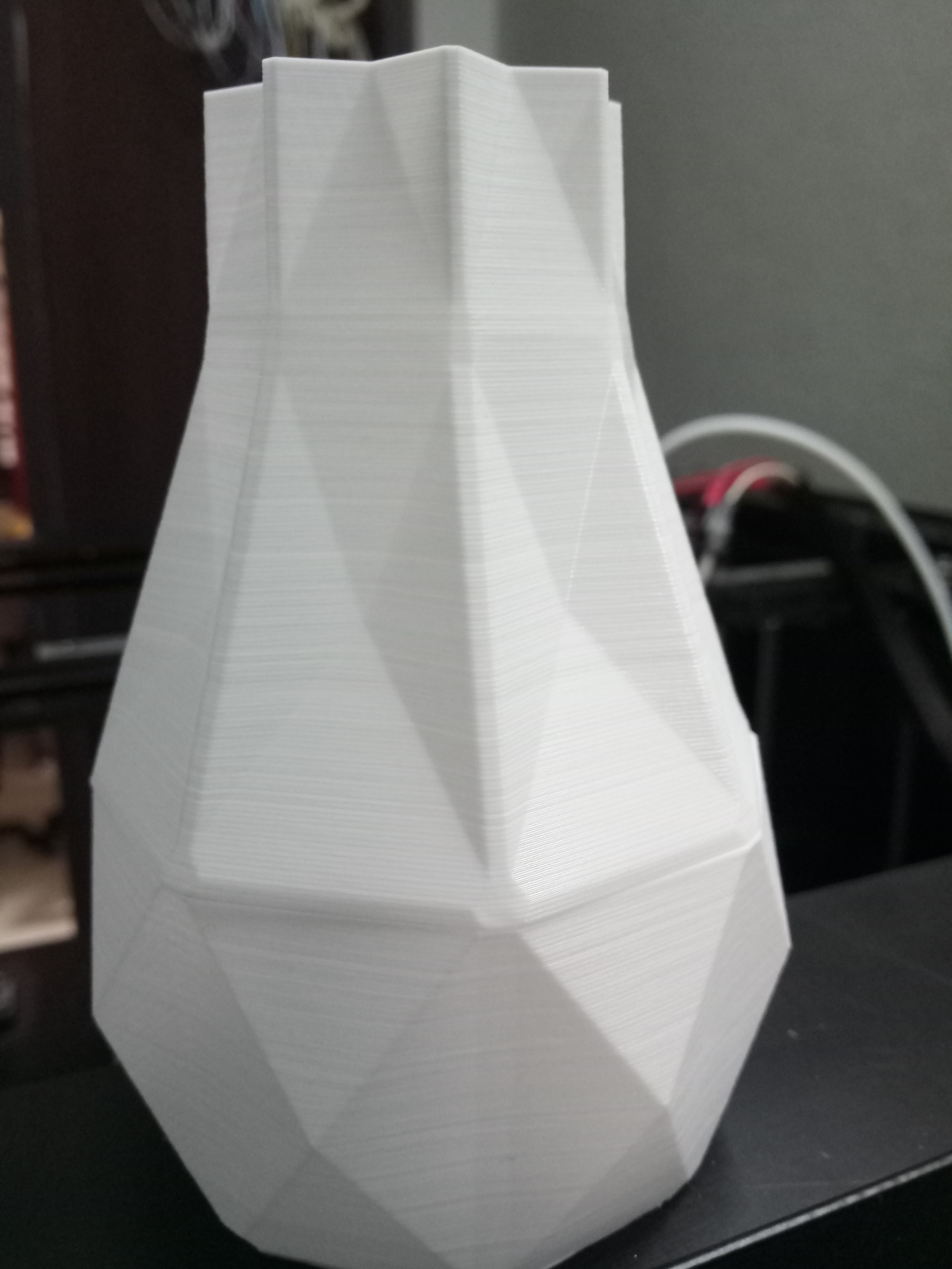

When printing with CoreXY -300mm machine, I am not getting satisfying results. Please find the attached image. It is having some issues in the perimeter. Printed with 200deg PLA.
