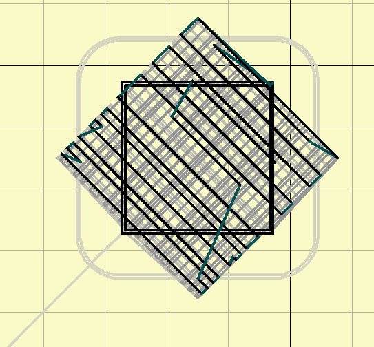

I am using the dev version of slic3r and i can’t seem to stop it producing a raft in the gcode. Anyone else see this?
Check your brim settings
Slic3r does rafts now??
Brim Is set to zero. Its generating actual raft and I can’t seem to find a way to turn it off.
@Pete_Prodoehl Yes, as of 0.99, I think
Under the Print Settings tab, support material you will find the 'Raft settings. Set Raft layers to 0.
Bug with a perl module
Boost Geometry Utils was upgraded to 0.8 to fix this issue. Upgrade it in your OS if you can.
I still see some failed tests when I run Build.PL after upgrading to 0.8, but it at least doesn’t do this!
I’m, luckily, still on 0.6; the build script for slic3r-git in the Arch user repository doesn’t force upgrade of boost libraries.
@Tony_Olivo @ThantiK thanks guys. I have just built a new machine and I thought I had done something really wrong when kept getting these results.
Just pulled the latest git and its been fixed: https://github.com/alexrj/Slic3r/commit/c2aa119c09350d1ea3d3cb1adb017d2dd2eddddd
