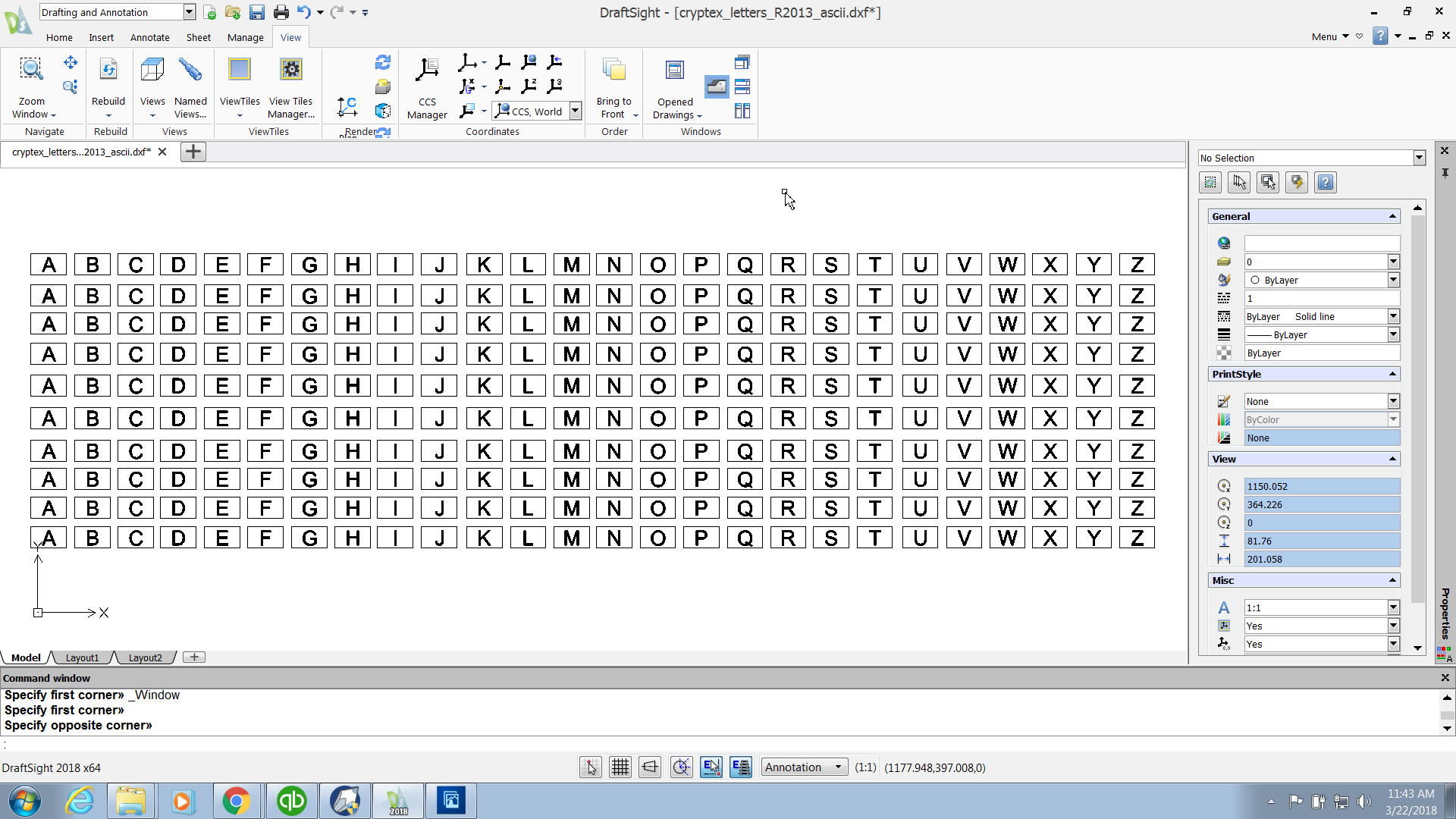

I am working on a Cryptex puzzle box. The dxf file came from user Da3da1u5 on the Instructables website. http://www.instructables.com/id/Laser-Cut-Cryptex/ Using Draftsight, I have sorted all the pieces into 8 x 12 blocks to match my laser travel. All the pieces worked out fine, except the letters. If I open the dxf file using DraftSight, the letters appear as they should (see photo A). CorelDraw 12 will not open the dxf file, so I thought I would open the dxf file in Inkscape, then save it as a WMF file which will open with CorelDraw 12. However, when the dxf file opens in Inkscape, it looks like photo B. Anyone know how to correct this?

I solved it the long way. Instead of using the dxf file I downloaded, I just started from scratch in DraftSight. I made a top row of squares, then created individual letters A-Z. With one row done, I used the array feature to get 10 rows all the same.
