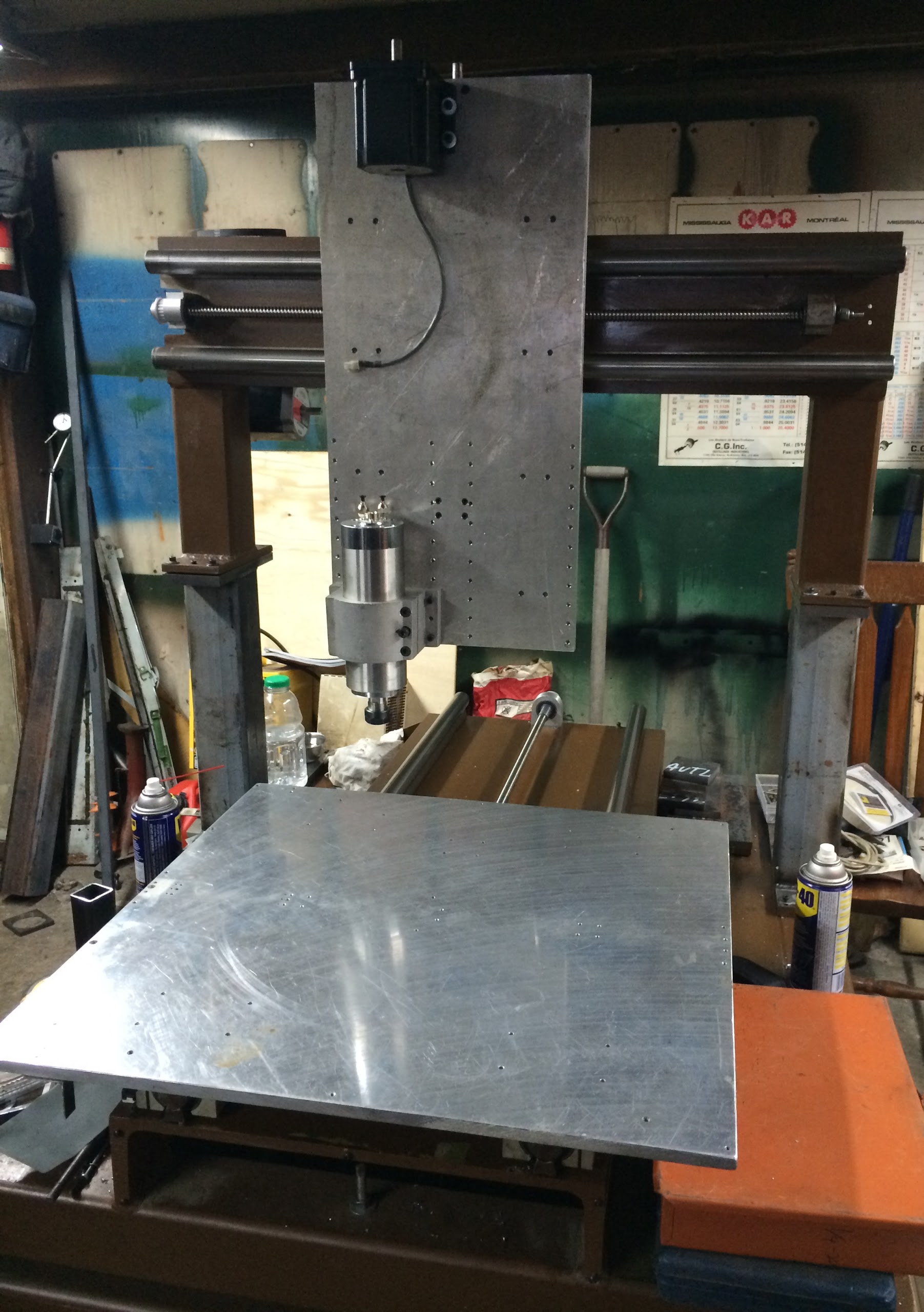

I begin my CNC, the hardware is part of assembly 27"x26"x20"
But I don’t have software to convet step/stl to gcode, I would like suggestion for software, free or low budget
I would like to use march 3 to controls
Thank you

Great work
Wow. That looks heavy duty. Plus lots of wd40. Be interested on people’s suggestions on software

@ahmed_ali Thank, I work on this for 1 year on partial time
