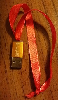

@Christopher_Elmhorst Did you get a USB key with your K40? (looks like a thumb drive but it isn’t)
You will need to have the USB key to us the original software (i.e. LaserDRW assuming you have the M2 Nano board)

So I plugged in the laser and the Dongel thing, and it automatically installed to my computer. I go to my control area on the computer and I see it’s connected, but it doesn’t pop up as a printer. Nor when I go to print from CorelDraw it doesn’t pop up as an option, I can’t find anywhere on how to set it up as a printer
@Christopher_Elmhorst that is your problem. The Laser does not show up as a printer. Corellaser is the gateway to the laser functions. When you install all the software including Corel, you have to run Corellaser to get the laser functions. It will start Corel. It will initially show up as a bar at the top of Corel and then become an icon in the system tray. Right click the icon in the tray to get to the laser functions.
