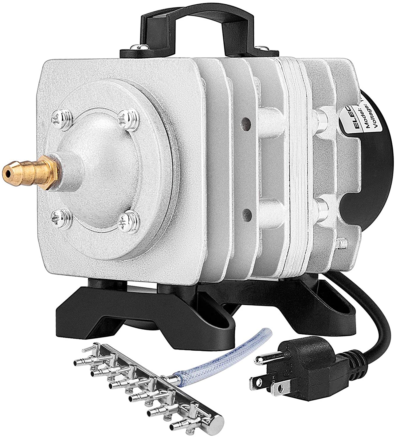

I got this one. Works fine. Now I’m trying to figure out a good fume extractor.

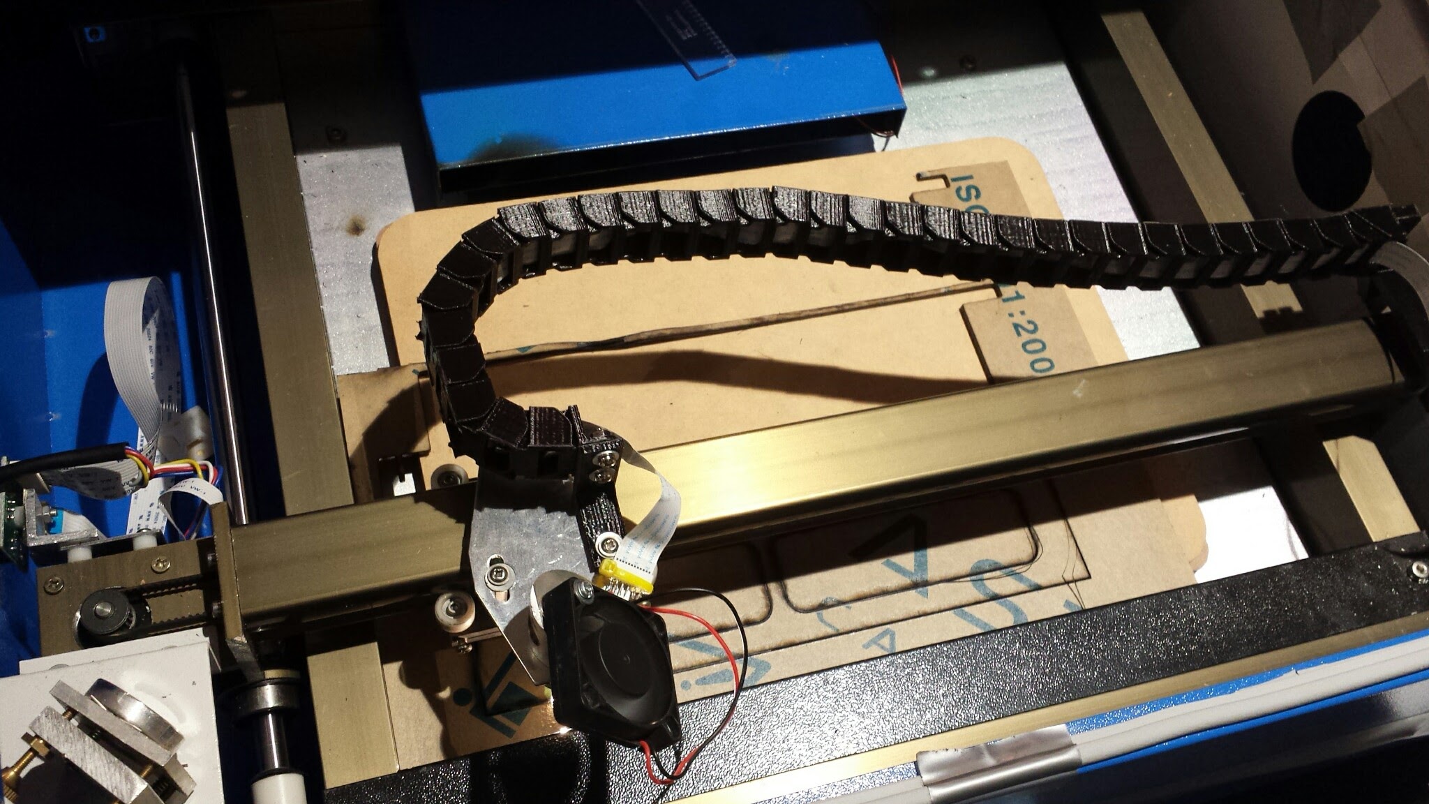

I’ve seen some people use small fans like on a 3D printer and swear by it. I haven’t tried it personally but it does seem to be a viable option.

I think @HalfNormal uses a fan. I am happy with my compressor see my blog.
@donkjr I use a BIG pump!
Ha, somebody out here uses a fan on the gantry?
@donkjr Finally found one of the old posts. Looks like @Paul_de_Groot uses a fan. Google Workspace Updates: New community features for Google Chat and an update on Currents
Edit: This is the updated link to that old post since people are still finding this old post ![]()
Ha! It looks like he just screwed a radial fan on using the mirror hold down screw. If it works, that’s great. The next comment after his uses a radial fan on a more permanent mount. However, in both cases the smoke could get up into the head and leave deposits on the lens and/or mirror. My idea for a blower fan would have the same drawbacks. When my new head/lens arrives, I think I will try using the wimpy pump I have now first (it will push smoke away from sensitive part$), and then go from there based on the performance. The pump I have is super quiet. I might try keeping it and using the blower fan mounted on the head bracket.

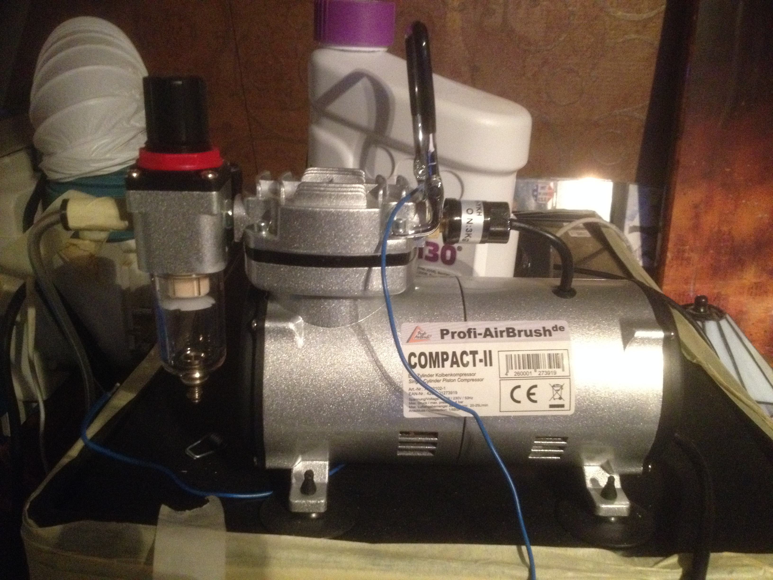

I think you could not use a fan, because you need a way to get fresh air from outside into it. I use a 50€ paintgun compressor that i bought on amazon.
@BEN_3D How loud is it?
It is louder then the waterpump, but not louder then my dust fan. And the complete set is louder then my 3D Printer. It is may so loudly as my clothes washing mashine.
I had a air brush compressor but it was loud and did not put out as much air as this.
