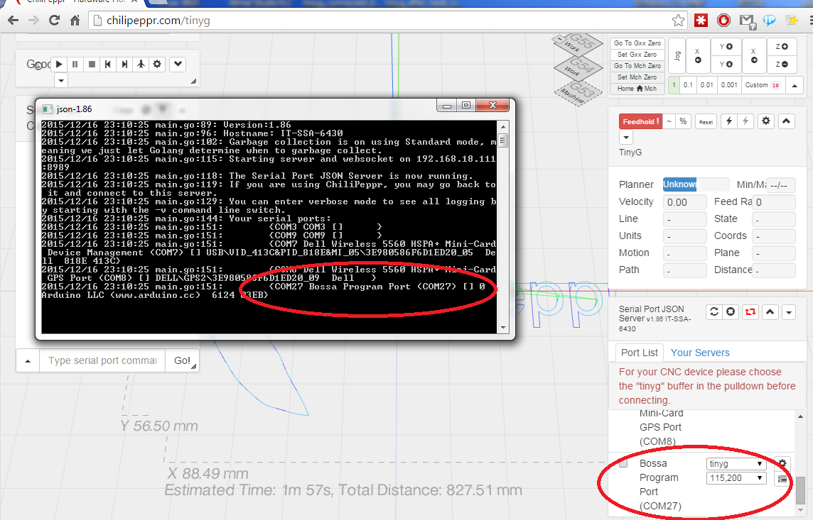

Every first time I connect the Due/gShield to my PC I see Bossa Program Port (which I would normally expect with no TinyG firmware present) and not two TinyG ports. Pressing RESET on Due (or gShield) solves the problem until next time I need to connect. I replicated this already on two different Due boards - same result.
