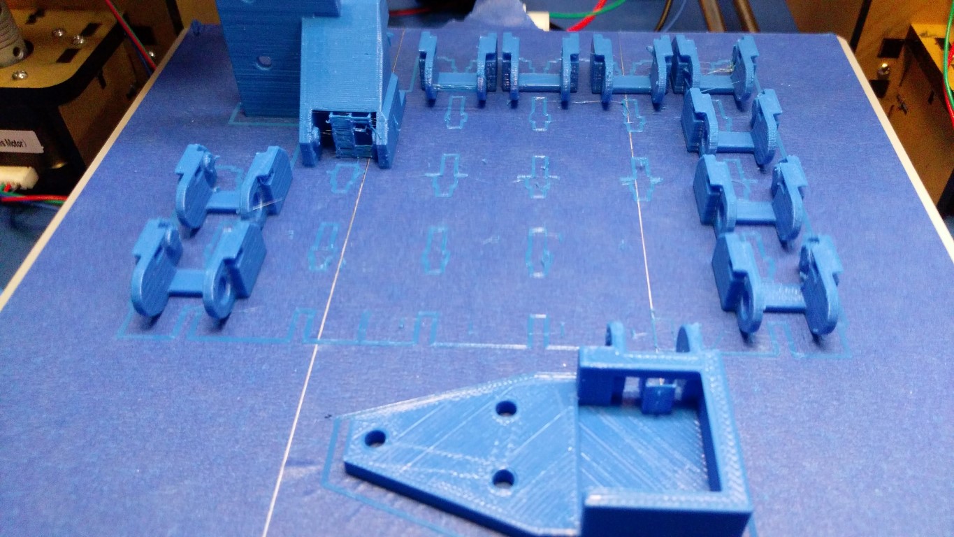

I bought an Anet A8 a few weeks ago and have had issues with the bed being warped since day one. I am forced to either build a raft every time, or keep an extra close eye on the print in the beginning to make sure the parts are building okay. It is a 220mm x 220mm heated aluminum bed. So I was wondering what a recommended replacement would be. I know very little about these things and have maybe 40 hours of print time on the machine.
Sorry for the bad photos. For the life of me, I cant figure out how to get my HTC A9 phone to take a good picture under LED track lighting.
Some upgrade parts I have been making:
