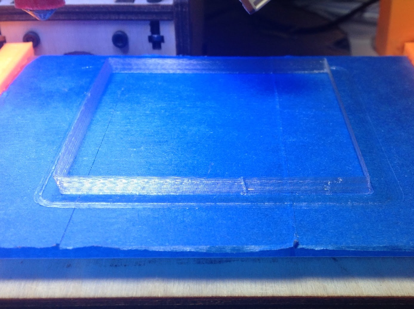

I bought the printrbot simple tensioner kit thinking it would fix slanting in X.
I bought the printrbot simple tensioner kit thinking it would fix slanting in X. Argh! Nope now it slants the other way.
It’s very doubtful it’s slipping on the sandpaper drum. Maybe on the shaft?
There is one last thing I can try, disassemble everything to pull the X motor then reattach the zip tie.
Any other ideas why X slant?
I think this is a firmware issue because how could the slant be so uniformed from a slippage problem.
