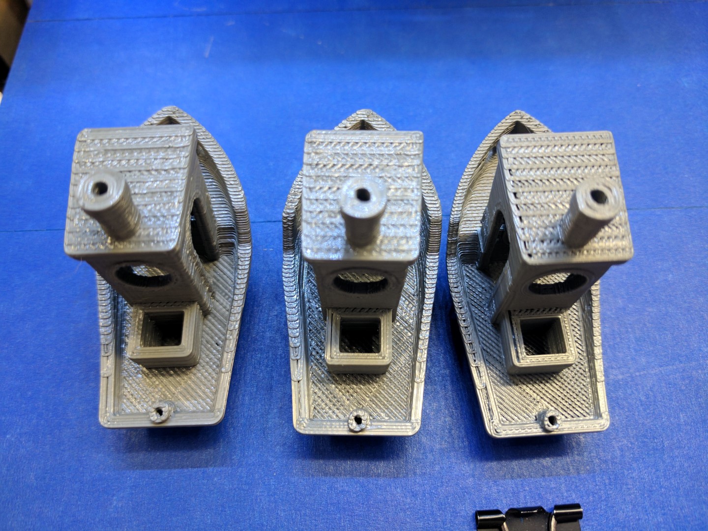

I broke down and purchased Simplify3d tonight and printed a Benchy boat.
I broke down and purchased Simplify3d tonight and printed a Benchy boat. The far left one is from before I stabalized my Anet A8 frame. The second one is after the modifications and Cura 14.07 mostly stock settings at 50mm/s. The third is stock Simplify3d at 50 mm/s. All of them were made at 195 degrees.
I can see already that the Simplify3d one has too thin of top and bottom and may be under extruding. I will have to goof off with it more tonight or tomorrow. Unless someone has some insight for us Anet A8 users.
Oh yeah… Why did the stack come out that way in the third one?
Had same Problem when i tried Simplify3D first time. Be carefull! Because Standard Extrusion Multiplier in Simplify3D is lower then 100%. For me was 90%! … I Changed this to 100% and everything went good…
Just bear in mind that for me (on my Kossel Mini, and on my Original Prusa i3 MK2), an extrusion multiplier of 0.9 (Kossel) and 0.95 (Prusa) seems to be right with Simplify3D. I ran for ages with an extrusion multiplier of 1.0 because I thought the same “hey, that must be wrong, I’ll fix that” and almost none of the print-in-place prints worked for me with the Kossel – dropping back to the default of 0.9 fixed that and made my prints noticeably neater. So it’s there for a reason – couldn’t get Simplify3D to explain why; I did try.
Like @Karl_Schlacher ​ saud, Set the multiplier to 100% and take a look at the top/bottom layer settings. Once you get done goofing you will love it.

Thanks for all the input. I found out that my bed was screwed down out of square. That’s why the stack looks kinda odd. And 1.02 for the extrusion multiplier works for now. I will definitely be creating profiles for different materials.
