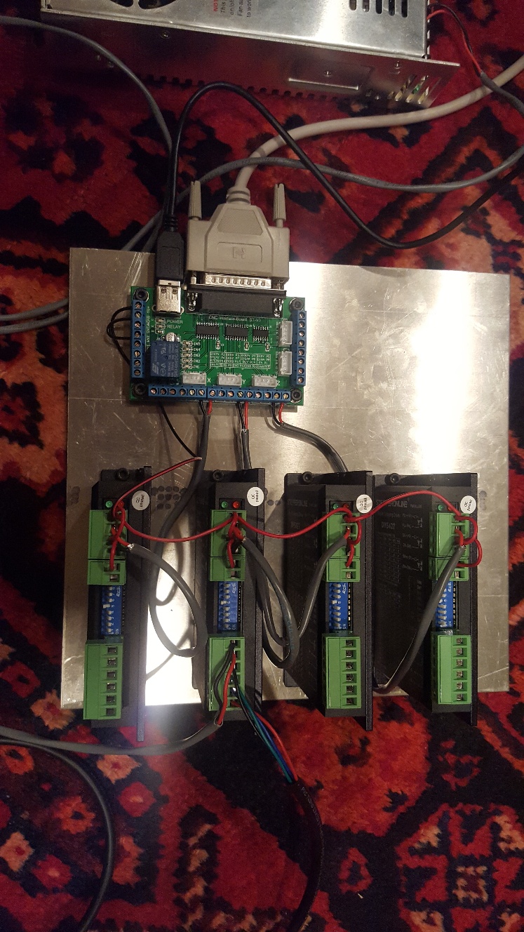

This is a picture of the controller that I am using to run PathPilot. I will post links to where I brought the parallel port breakout board and the stepper motor drivers.
@Arran_Biiby

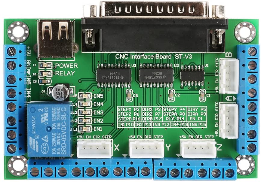

This is the Parallel port breakout board I used.
@Arran_Biiby
