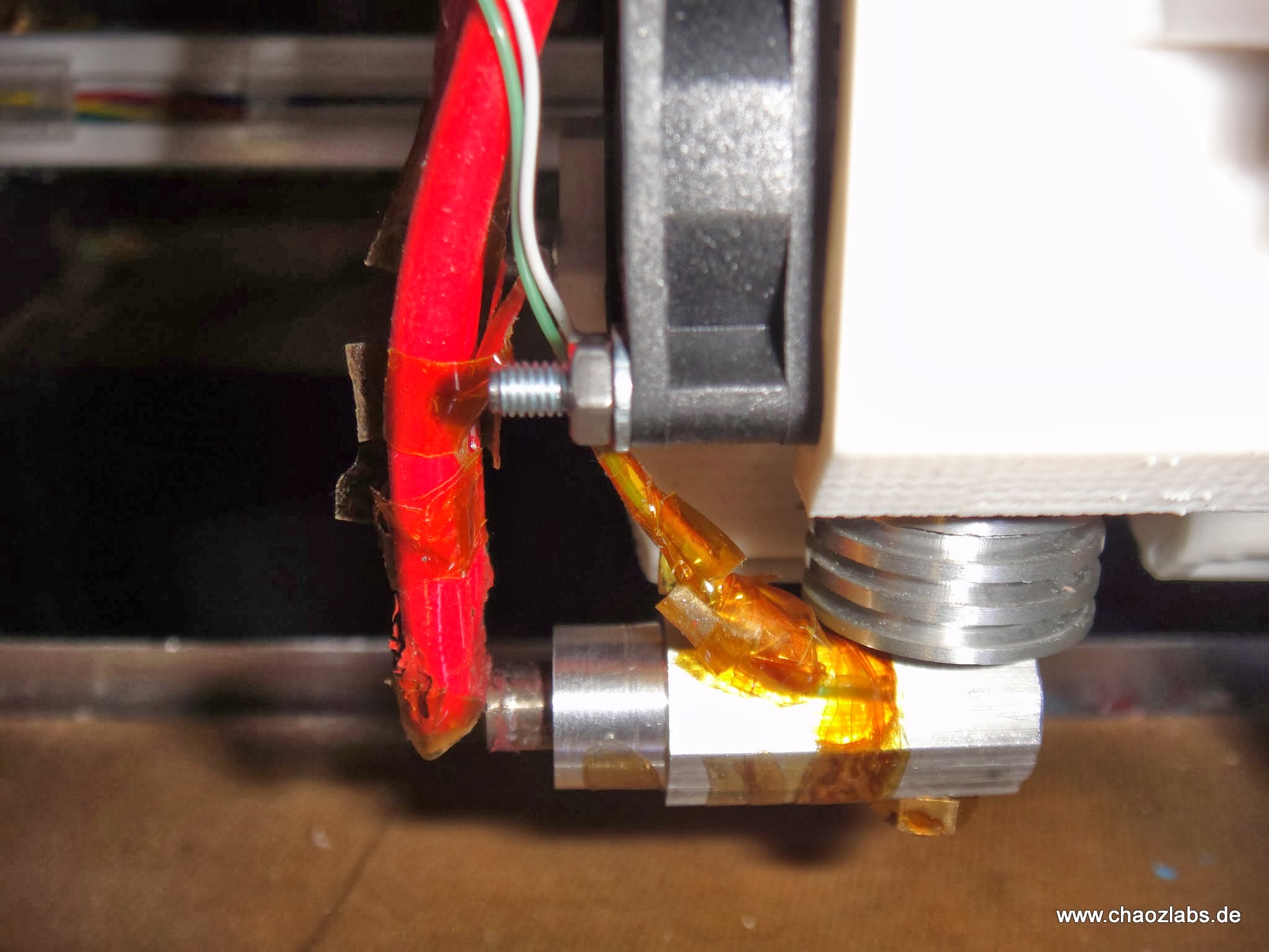

I build this modified version of the e3D-Hotend,
I build this modified version of the e3D-Hotend, the nozzle and the heat break are original. The heatsink and heater block are custom made. For the heater block I used a 12mm aluminium hexblock. It works great and improves the cable management.
