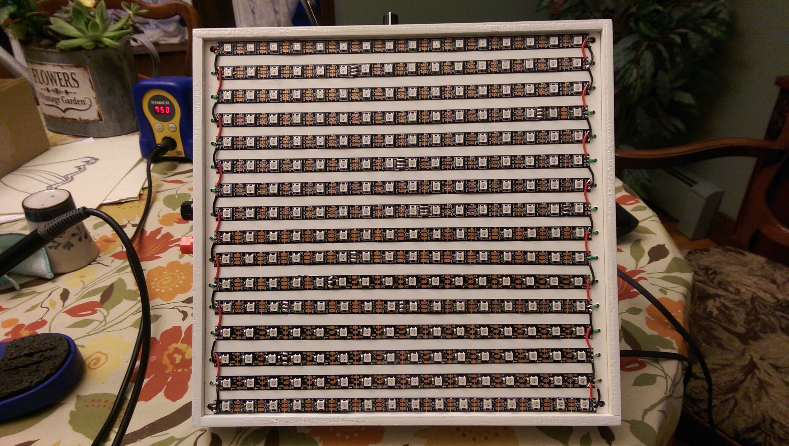

I built a 16x16 matrix maybe 6mos ago (teensy 3.2, ws2812b),
I built a 16x16 matrix maybe 6mos ago (teensy 3.2, ws2812b), tinkered for a bit, and it’s sat for the majority of the time since. I have a maker event at work and am planning to show this and wanted to finish up some details. To my surprise, it was acting really weird! Behavior:
  • I have a spectrum analyzer and noted that the low end was lighting up really erratically and crazily
  • I ran a pixel test with full white, one at a time, and found that one pixel is more of an orange color
  • I have a “rolling ball” routine where you can control which area illuminates by tilting it around and only when I get into the area of the orang-y pixel does it do the erratic behavior
Short video examples:
Hopefully the picture illustrates some of the wiring? I was convinced that soldering those short jumpers so close might have melted through the insulation and shorted data/gnd or data/5V, but I just de-soldered some redundant gnd and power from that strip and am not seeing a difference.
I’m hoping someone here has seen something like this and will just say “Oh. Yup. I know just what’s up.” Hoping this doesn’t involve too much extra work to fix!
In the meantime, I’m going to de-solder everything to that strip and try to control just it directly. I’m guessing if that doesn’t work, it means I’ve got a bad strip? Not sure how it would go from good to bad sitting on a shelf… then again, it’s the top of the shelving unit that holds my kids toys :slight_smile:
Many thanks.

Well, I guess that resolution was quick. I should have just tested before posting… I think I didn’t want to believe it was a bad pixel :frowning:
Short story is I de-soldered all the matrix connections from that strip and isolated it to connect directly to an arduino. It wouldn’t send the data at all. Doing the loop above (with just pixels 0 through 15) only blinked the first!
I left power and ground connected to the first pixel, but soldered the data line to pixel 2 and it worked! So, I’ll carefully peel up, cut that pixel off, and splice in a new one.
Nice repair job! :slight_smile:
@marmil Thanks! I just cut out the bad pixel and soldered in a new one. Seems to work flawlessly. Kind of wild. I really lucked out it was the first of the strip!
@John_Hendy If it had been leds[0] I was going to ask if you were using a resistor on the data line, thinking maybe that’s why it went bad, but seeing that it looks to be leds[16] I have no idea why. RBPH (random bad pixels happen)
