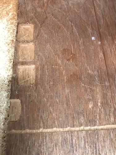

Now that it works, it’s time to tune it up. The problem I’m having is with the Y stepper motors. In the attached photo Y is left to right. Those 3 squares should all be in a straight line, not staggered. One Y motor (the one with the longer wires) seems to be lagging the other Y motor in starting and stopping. At times the lagging (or lack of movement) is causing the opposite (leading motor) side, to misstep. I am at a loss of what I should try first. Are there known ‘safe’ configurations for steps, current, etc. that I should try in the config file. I doubt the belts are too tight since I can lift one end and the whole gantry will slide down to the other end. There are so many variables in this that I’m not sure what I should troubleshoot first.

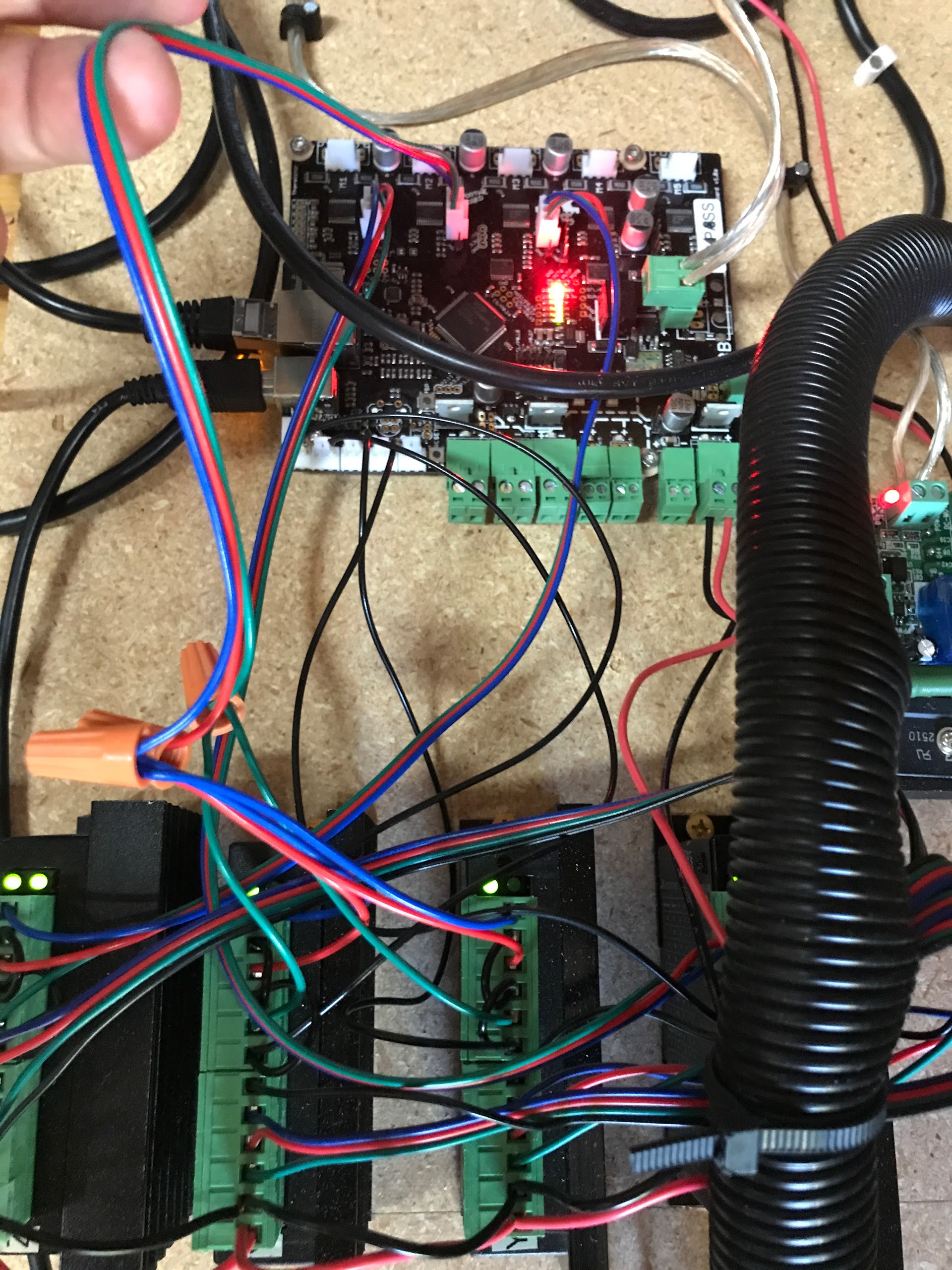

I am taking the signal from the Beta Step, Enable, and Dir pins and running those in parallel to the negative inputs on 2 separate motor controllers on TB6600 motor controllers. The + on the TB6600s are going to the smoothie endstop ground pins. I originally tried to connect the motors in serial; from the smoothie to TB6600 (+Y) to TB6600 (-Y) with the same results.
The first question should probably be is my wiring OK? Can I tee off the commands and go to 2 motors? If not, can I go to 1 motor and then jumper the motors?
