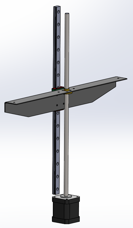

I really like V-slot / V-Wheel combo as the guides on Z. Another option would be ground linear guides instead of shafts or v-slot (see the image below as an example on a project I have been working on). The price of these ground guides and blocks is a lot lower now a days, and they are more compact. That being said the v-slot Z-stage on HercuLien has always been unbelievably repeatable for me. So you can’t go wrong.

@Eclsnowman I have two of those in the garage but they are horizontal only. Do you get any deflection in your valor?

@Rick_Sollie HercuLien has 20x80 as the z-guides. The 80 is in the direction deflection forces would be. If you deflect that… You are doing it wrong
But seriously, the wheels being cantilevered on 5mm bolts would be your source of deflection. But if it helps I haven’t releveled my HercuLien is a year+
